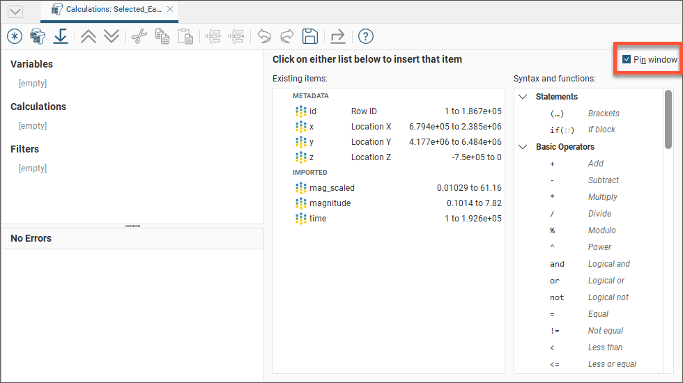

The Calculations Window

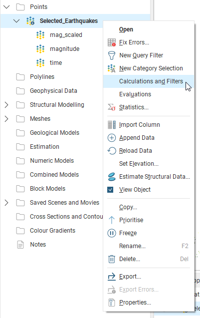

Right-click on a drilling data table to find the Calculations option or on a points table to find the Calculations and Filters option.
The Calculations and Filters option is not available for all points tables.

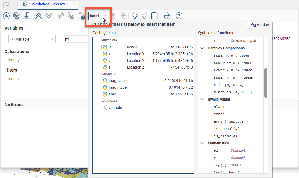

When the Calculations window is first opened, the Insert list is pinned to the right-hand side. You can untick the Pin Window box to get more screen space.
You can then select items by clicking on the Insert menu.
Items in this list are divided into Existing items and Syntax and functions. Existing items include handy metadata items you can use immediately, e.g. row ID and point location coordinates. It also includes evaluations that can be selected, such as estimators. Syntax and functions contains mathematical operators and other calculation elements, along with special values such as 'blank' and 'error' and pre-made functions such as unit conversions and log(n).

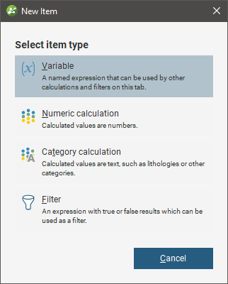

Click the New Item button to add a calculation to the Calculations window.
The New Item windows gives you the choice of creating a variable, a numeric calculation, a category calculation, or a filter. Select one of these options, enter a name for the new item and click OK.

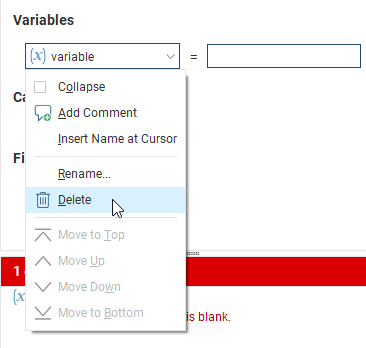

If you want to delete an item, click on it in the list, then select Delete:

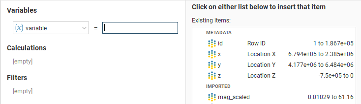

Variables
A Variable is an expression that is given a name to make it simple to refer to the expression in other parts of the Calculations window. Note that ‘variable’ is a homonym/homograph that in a different context has a different meaning; ‘variable’ is at times used to refer to a mineral such as gold or silver. In the context of calculations and filters, the meaning is aligned with the use of the word in mathematics and scripting languages.
Using a variable in calculations can make the calculations easier to read and understand. It also makes it simple to reuse an expression multiple times in different places. Any time you find the same expression appearing in different calculations, or in different parts of a calculation, split that expression out into a variable. You can even use a variable to represent a constant value, such as a particular density measure. You can use it to hold a value you want to change as you experiment. If the value is used in multiple places in other expressions and calculations, using a variable in those places means you only need to change the value in one place instead of many.

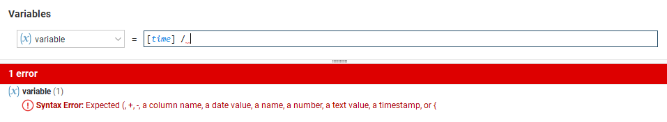

The errors pane will report when the syntax of an expression cannot be validly interpreted. It cannot report when the expression is not correctly structured to do what was intended.
While you are in the process of constructing an expression, errors will be reported when the incomplete expression cannot be validly interpreted:
The messages provide the reason the expression is not valid or complete, but it cannot tell you how to complete or correct the equation.

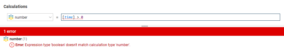

Other errors will be displayed when the type of result doesn't match the sort of calculation selected when it was created. A numeric calculation needs to produce numbers, a category calculation needs to produce text results, and filters need to produce true or false (boolean) results.

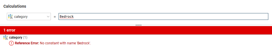

Text needs to be identified by enclosing it with quotation marks, so it is not mistaken by the calculation engine as some sort of unspecified constant.

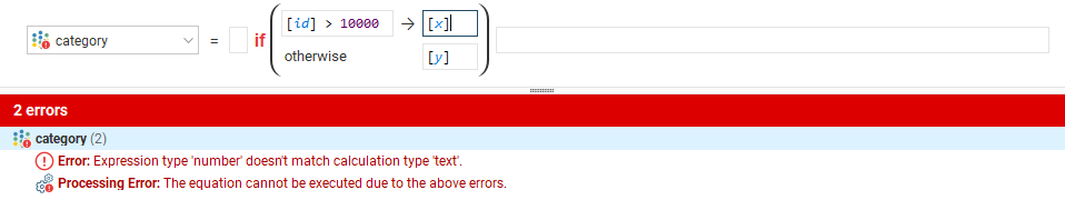

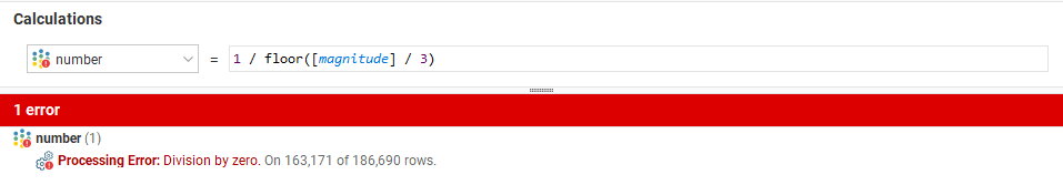

A processing error indicates a problem executing part of the calculation for at least one of the points. The function may be syntactically correct, but the calculation cannot be performed for one or more points for some other reason. In the example below, number will not be able to be calculated if magnitude is ever below 3, as that will result in a divide by zero error. Because magnitude ranges from about 0.1 upwards, this does indeed cause a processing error. Not all processing errors will be divide by zero errors. The list of problems that will be reported as processing errors includes:
  • divide by zero
  • log of zero or a negative number
  • log base of 1
  • raising a negative number to a fractional power
  • sqrt of a negative number
  • numeric overflow, producing a number outside the range -1e308 to 1e308

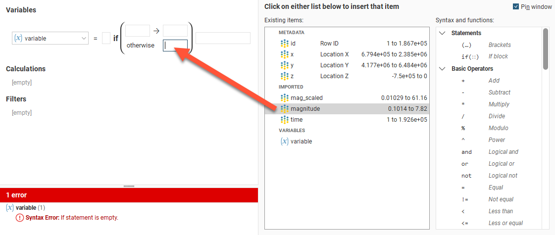

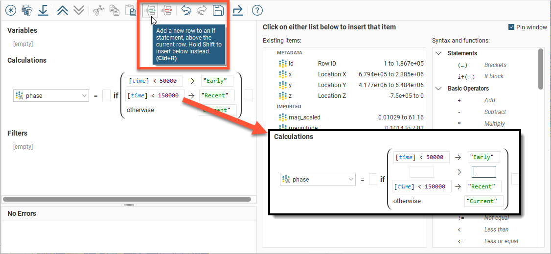

Some items you insert include placeholders that need to be replaced. For example, here, a value needs to be entered at the cursor position and the terms ‘lower’ and ‘upper’ need to be replaced with other items.
The if (::) conditional statement can have additional rows added to it. Insert the cursor where you want to insert a row and then click the Add Row button () and a row will be added above the selected line.
You can hold the Shift key to add the row below the cursor. To delete the selected row, click the Delete Row button ().

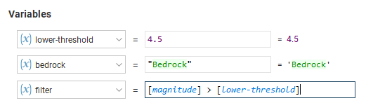

Examples of Variables
Variables can produce numeric, boolean, or text results. You may create a variable because using a variable in other expressions can make them easier to read and understand, or it can let you change a value in just one place, even though it is used in many expressions.

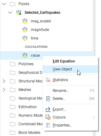

Example of a Numeric Calculation
Numeric calculations must produce numeric results, or an error will be reported.
The results of the numeric calculation for the points object can be viewed in the 3D scene by right-clicking on the numeric calculation entry in the project tree and selecting View Object.

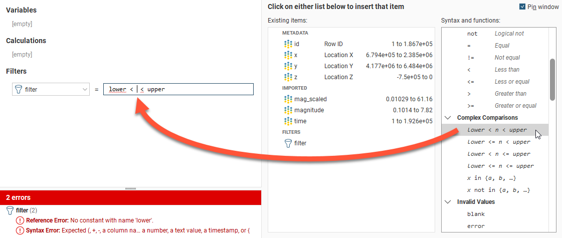

Example of a Filter
In this example, one of the selectors from the Complex Comparisons options was chosen from the insert list. The value that will be tested is to be added at the insertion point between the comparators, and the placeholder words ‘lower’ and ‘upper’ need to be replaced with constants.
Here the numeric column [time] has been specified as the value that will be tested, and lower and upper limits have been specified.
When you select View Object for the filter in the project tree, the Query filter is set to the selected filter in the shape properties panel.

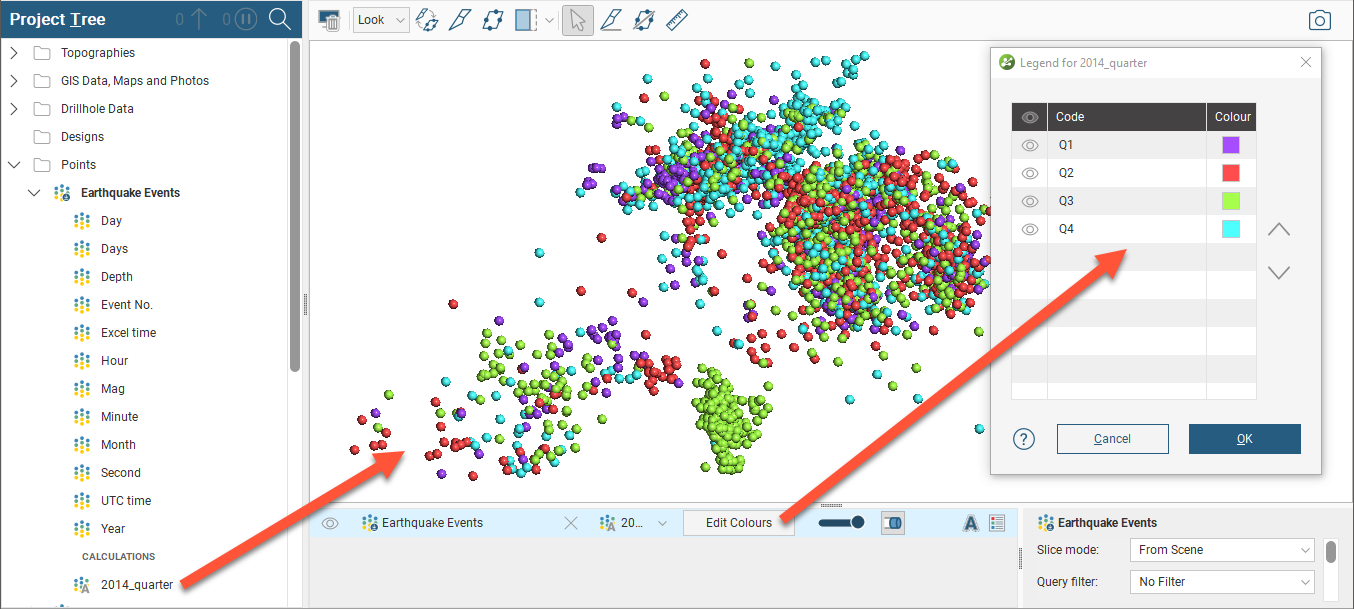

Example of a Category Calculation

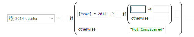

This example uses a category calculation to organise events into quarters for the year 2014 using the if(::) conditional statement.
The if(::) conditional statement contains two lines by default. Note the guiding cues within the dotted entry boxes. The first line describes the test to be performed that, if it evaluates as true, will produce a specified result. The ‘otherwise’ condition on the second line captures all the tested conditions that did not evaluate as true in the test on the first line, and these all produce an alternate result:
In this case, all the values outside of the range of the filtering expression [Year] = 2014 are outside the period of interest. We add the expression as the ‘test’ condition, and specify the label "2014" as the first result, and use the label "Not Considered" in the bottom line for the ‘otherwise’ condition. So the labels are not mistaken by the calculation engine as some sort of unspecified constant, make sure labels are identified using quotation marks:

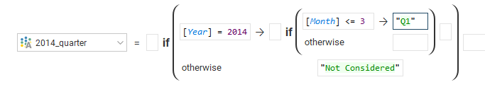

We need to extend this trivial example for organise the period into quarters, and to do this we can nest if(::) conditional statements. Replace the "2014" label with a new if(::) item:
Now if values pass the filter in the first test, they then get to be sorted using the second if(::) block. This time we will test the month field and if it is less than or equal to 3 we will classify this as "Q1":

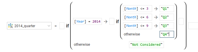

Shift-click the Add Row button (), and a new conditional row is added below the current one, where we can specify that a Month value less than or equal to 6 will be classified as "Q2". Only values between 4 and 6 will be classified as "Q2" as the first line will have already classified all the values under 4 as "Q1".
Repeat to add another row specifying a Month value less than or equal to 9 to be classified as "Q3".
This leaves the ‘otherwise’ row in the nested if(::) block to catch values above 9 which are labelled "Q4":
The new 2014_quarter calculation we have constructed can be added to the scene view. Click the Edit Colours button in the shape list to select which categories are visible.

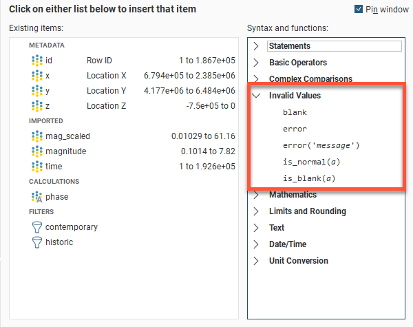

Null Values
Leapfrog Works can differentiate between different types of invalid or null values, which are shown in the Calculations window:
If you are using the Contaminants extension adding block models, you will have additional invalid values:

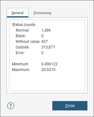

You can see how many points or blocks of each normal or invalid status occur in an evaluation by right-clicking on the evaluation in the project tree and selecting Properties:

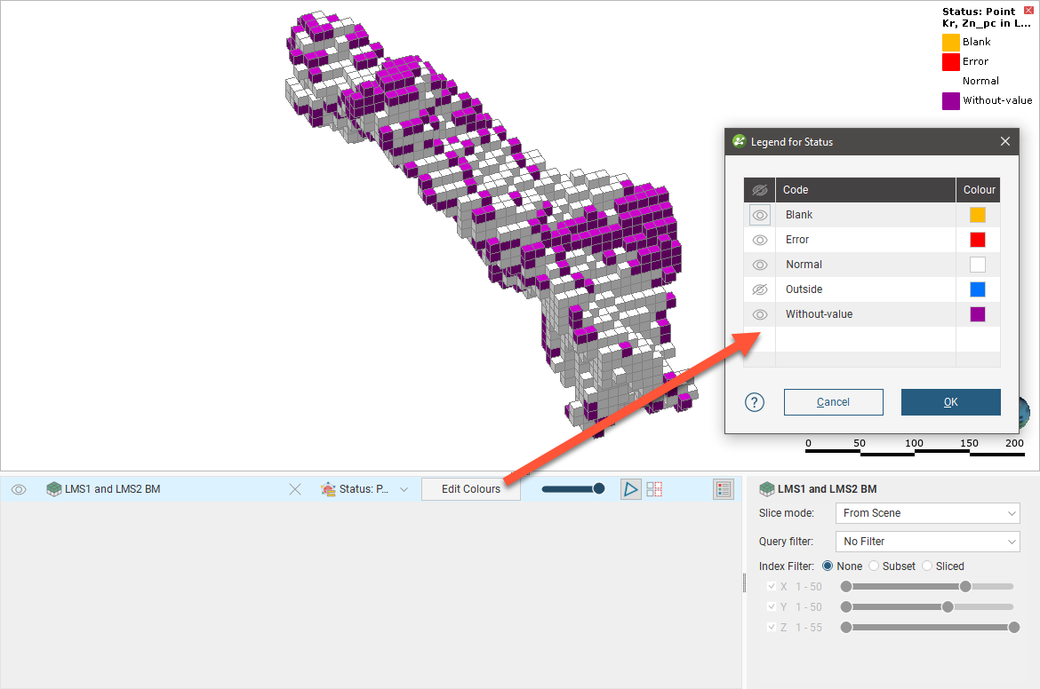

Invalid values can be displayed in the scene. When a block model is displayed in the scene, you can choose between displaying evaluation values or the Status. Highlighted below is a Kriging evaluation, shown displayed on the block model. Next to the Kriging evaluation in the dropdown list is a Status option:
When the status option is selected, the model is displayed by block status. Click Edit Colours to change what status values are displayed.
