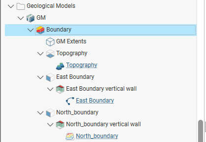

To create an extent, expand the geological model in the project tree. Right-click on the Boundary object and select from the New Lateral Extent or New Base options. Follow the prompts to create the extent, which will then appear in the project tree under the model’s Boundary object. For example, this geological model has two lateral extents, one from a polyline and the other from GIS data:
New extents are automatically applied to the boundary being modified. Leapfrog Geo usually orients a new extent correctly, with red presenting the inside face of the extent and blue representing the outside face. If this is not the case, you can change the orientation by right-clicking on the extent in the project tree and selecting Swap Inside.

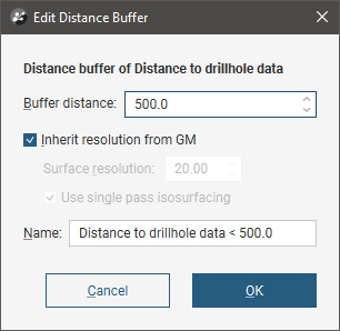

Leapfrog Geo can calculate the distance to set of points and use the resulting distance buffer as a lateral extent for a geological model. To create a new lateral extent from a distance buffer, right-click on the Boundary object for the model you are working on and select New Lateral Extent > From Distance To Points. The Smoothed Distance Buffer window will appear:
You can also use the Set to list to choose different options Leapfrog Geo has generated based on the data used to build the model. Isotropic is the default option used when the model is created.
To change the extent’s settings, expand the model’s Boundary object in the project tree and double-click on the extent. Adjust the Distance and Anisotropy, if required.
The resolution of extents is automatically inherited from the geological model. You can change the resolution for an extent if you want more or less detail than for the geological model as a whole. To do so, untick the box for Inherit resolution from GM and change the setting.

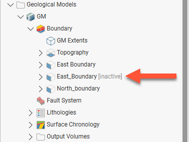

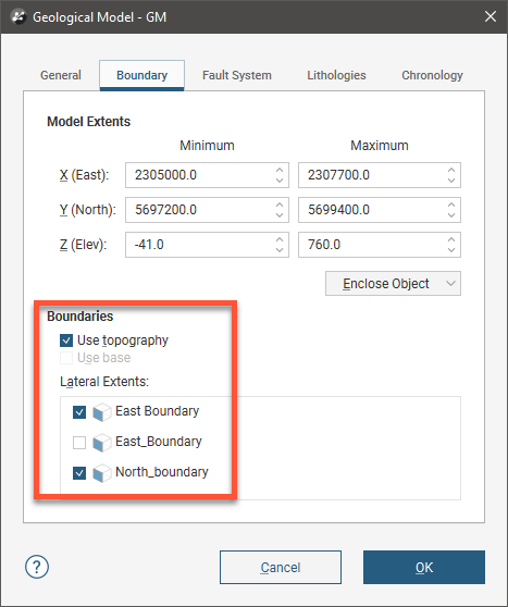

The second method is useful if you are making changes to the extent and do not want to recompute the model with each change. Double-click on the model’s Boundary object or double-click on the model and click on the Boundary tab. The Boundaries part of the window lists all objects used as extents for a geological model:
Untick the box for extents to temporarily disable them in the model. The model will be reprocessed, but you can then work on the extent without reprocessing the model. Disabled extents will be marked as inactive in the project tree:
