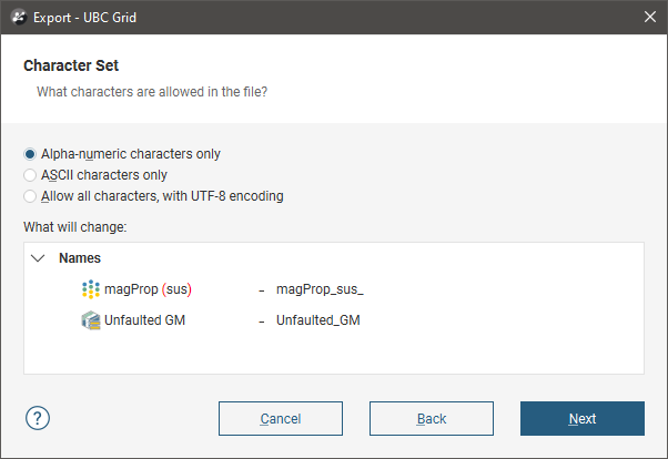

When a 3D grid is exported, non-Normal status codes can be represented in the exported file using custom text sequences.
The Status Codes sequences are used for category status codes and filter status codes exported as columns. For filter status codes, Boolean value results will show FALSE and TRUE for Normal values or the defined Status Codes for non-Normal values.
The selection you make will depend on the target for your exported file. You can choose a character set and see what changes will be made:
Once you have made any Character Set changes, click Next to view a summary of the selected options.

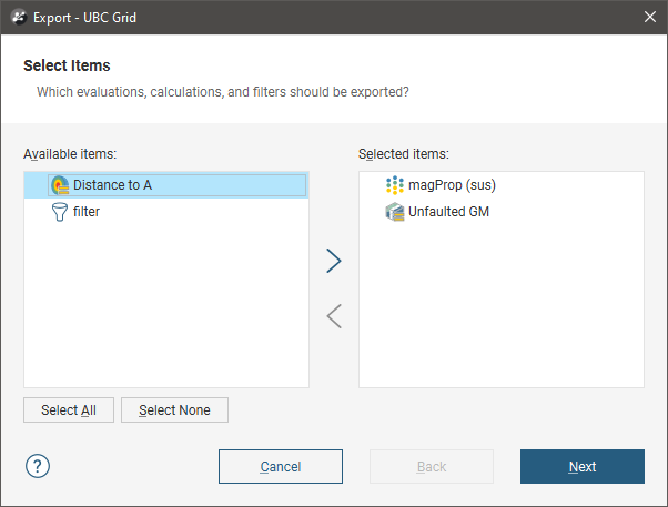

Exporting 3D Grids in UBC Format
3D grids can be exported in UBC format. To do this, right-click on the grid in the project tree and select Export as UBC Grid.

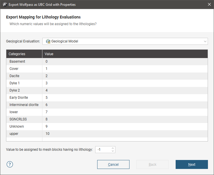

When a 3D grid is exported in UBC format with a category evaluation, category data is mapped to an editable numeric value. If the grid has any category evaluations, you will first be prompted to check the numeric values used for each category:
Double-click on a value to edit it. You can also change the value assigned to blocks that have no lithology.
Click Next to select the properties you wish to export and edit the file names used, if required.
If the grid has no category evaluations, this is the first window that will appear when you select the Export as UBC Grid option.

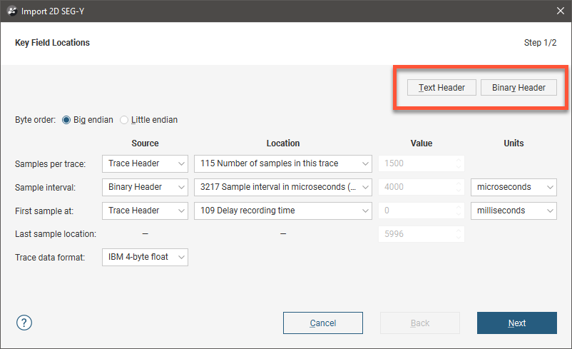

To import 2D SEG-Y data, right-click on the Geophysical Data folder and select Import 2D SEG-Y. Leapfrog Geo will ask you to specify the file location. Click Open to start importing the file.
Leapfrog Geo will read the data in the file and match the data to the expected format. In most cases, Leapfrog Geo will set the correct values from the information in the file.
There are two steps to work through. First, set up the Key Field Locations. There are buttons at the top of the window for displaying the Text Header and Binary Header, which may be useful in deciding what import settings to use.
You can keep the Text Header and Binary Header windows open while you work through the steps in the Import 2D SEG-Y window.
Settings for the Key Field Locations are:
- Byte order. This will be Big endian or Little endian and must be correct in order for the other data in the file to be read correctly.
- Samples per trace. This is the number of samples in each trace. If the correct value cannot be read from the file, you can set it manually by selecting User from the Source dropdown list.
- Sample interval. This is the vertical sample spacing for the trace data and is almost always stored in thousandths of true units. If the correct value cannot be read from the file, you can set it manually by selecting User from the Source dropdown list.
- First sample at. This is the delay recording time for the first sample. If the correct value cannot be read from the file, you can set it manually by selecting User from the Source dropdown list.
- Last sample location. This is read-only and is the calculated location from the last sample in the trace.
- Trace data format. This should be defined in the binary header.

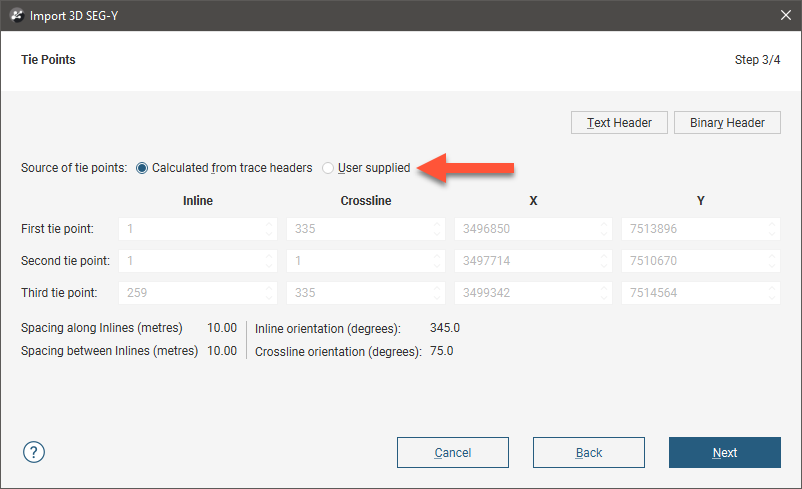

Click Next to move on to setting the Tie Points. By default, these are calculated from the trace headers, but if they are not in the trace headers or if you have more precise values from the text header or from another source, click User supplied and entering these values manually.
The Spacing along Inlines and Spacing between Inlines fields are calculated from the specified tie points.

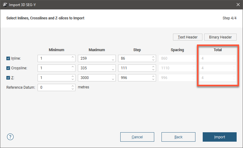

Click Next to move on to selecting the slices you will import. The Total column tells you the number of in-lines, cross-lines and z-slices that will be imported.
If you wish to import fewer or more slices, adjust the Minimum, Maximum or Step values, and the Total number of slices will be updated:
Once you have imported 3D SEG-Y data into a Leapfrog Geo project, you can add more slices and delete existing slices if you need to. This is described below.
