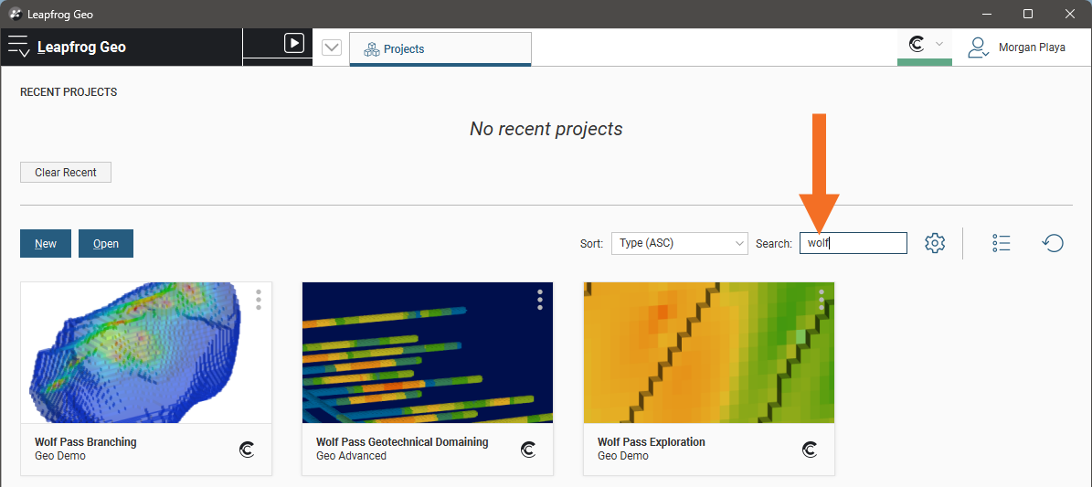

Once you’re connected to a Central server, the Projects tab shows all the projects you have access to. Use the search bar to narrow down the list of projects displayed.

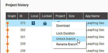

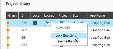

To lock a branch, right-click on it in the project history and select Lock branch:
In the window that appears, set the Lock duration and add any comments. The lock can be set for as little as one day; when the lock expires or when a new publish is completed, the branch will be unlocked for other users. While the branch is locked, other users are still able to download projects, create new branches and publish to branches that are not locked.
If you locked a branch, you can unlock it before the lock expires by right-clicking on it and selecting Unlock branch:
You can also ask your Central administrator to unlock a branch.
You can also extend how long the branch will remain locked. To do this, right-click on the branch and select Lock Duration.

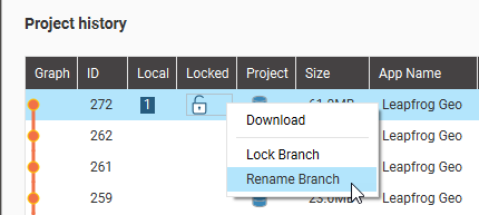

Renaming Branches
To rename a branch, right-click on it and select Rename:
Enter a new name for the branch, then click OK. The project’s history will be refreshed.

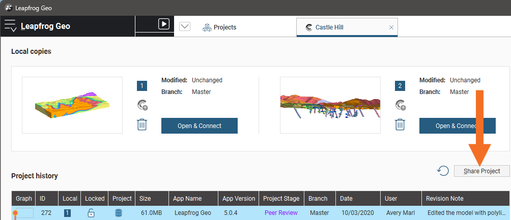

If you are a project’s owner, you can share it with other Central users by clicking the Share Project button in the project’s history tab:
Clicking Share Project opens the Central Portal, displaying the list of users for that project.
You may need to sign in to the Portal.
You can select from the other users in the system or enter a user’s email address, then assign their permissions.

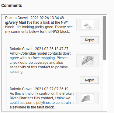

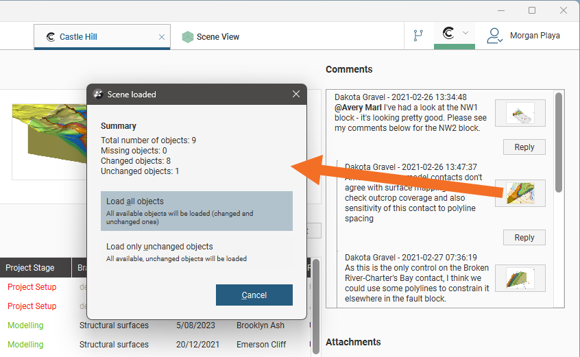

With comments, Leapfrog Geo, Central Portal users can carry out conversations about specific aspects of the model. Comments include a scene snapshot to help you point out specific features in a model to your team. If you already have the project downloaded and open in Leapfrog Geo, you can load the current version of the object referred to by the comment. Click on the scene snapshot; you will be prompted to load all the objects or only the unchanged objects:
If the snapshot has a geotag, it will be added to the shape list and displayed in the scene.
If the project is not open, the scenes shown in comments will be greyed out:
You can draw the attention of another user to a comment by using an @ mention. When you type @ in a comment, a list of users who are assigned to the project appears. As you continue to type, the list is filtered to make it easier to select an individual from the list. When an @ mention is included in a comment, the named user will have a message appear in their notifications in the Central Portal. For people who access Central mainly through Leapfrog Geo and who rarely use the Central Portal, it is recommended that email notifications are enabled. When they have email notifications enabled, a user who is addressed using an @ mention will also receive an email notification of the message.

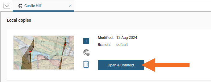

Click the Open & Connect button in the Local copies panel to open the project:
Work in the project as you would any other Leapfrog Geo project, then once your work is complete, you can publish a new revision, as described in the Publishing to Central topic.

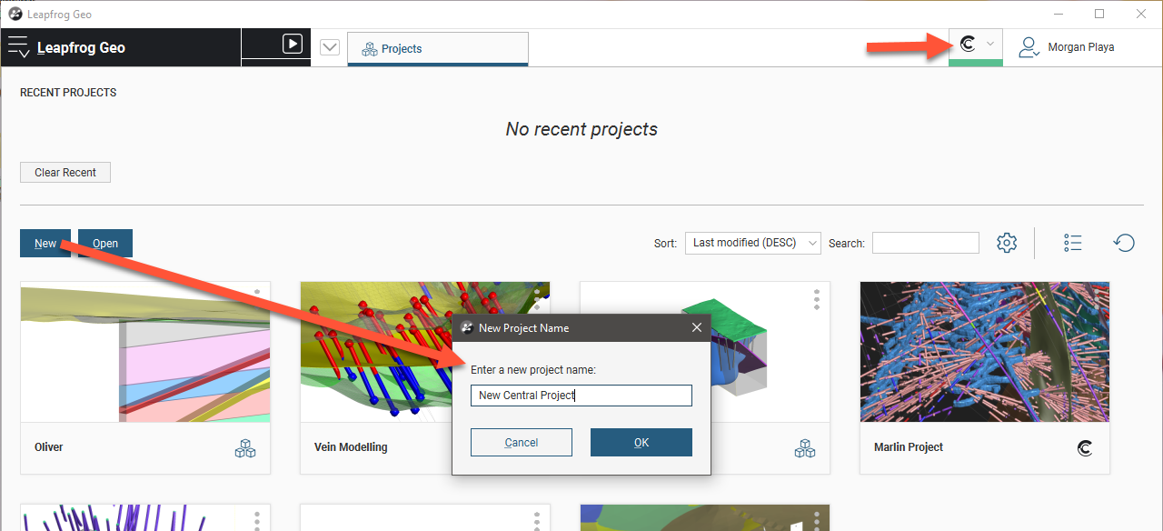

Use this option to create a new Leapfrog Geo project and put it into Central. In the Projects tab, first make sure you are connected to the Central server you wish to add the project to. Then click the New button:
Enter a name for the project and click OK.
A new Leapfrog Geo project will be created and saved in the location on your local drive specified in the Settings > Projects window.

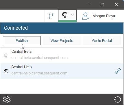

Work in the project as you would any other Leapfrog Geo project. When you are ready to publish the project to Central, click on the Central menu and select Publish:

Click on the Central menu and select Publish.

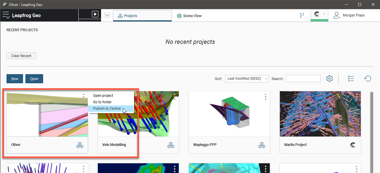

You can also import a project from the Projects tab. Click on the project’s overflow menu (
) and select Publish to Central:

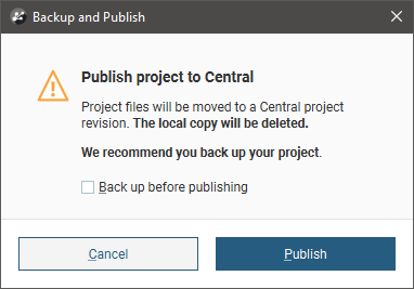

When prompted, enter a name for the project and click OK. Next you will be prompted to backup your project before it is published to Central:
Tick the box to back up the project, then select where on your local drive you wish to save the backup. Once the backup has been created, a new Central project will be created and the existing project will be copied to the location on your local drive specified in the Settings > Projects window.
