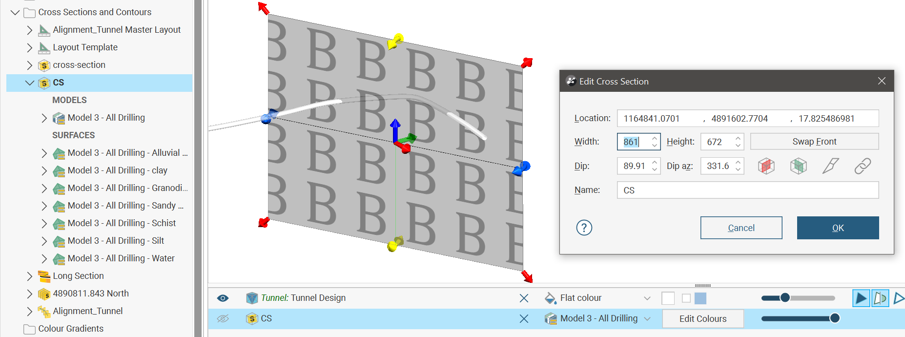

  • A typical cross section is a vertical plane with an image or geologic cross section applied to it. In Leapfrog Geo, this type of cross section can be created directly in the scene, from the slicer or from an imported image.
  • A long section is one section or a series of sections that deviates from a straight line. In Leapfrog Geo, a long section can be created from a polyline drawn in the scene or from any line object in the project.
  • A serial section is a series of typical cross sections taken at an offset from a single base section.

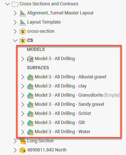

Objects evaluated onto a section will appear in the project tree under the section object, categorised into MODELS and SURFACES.

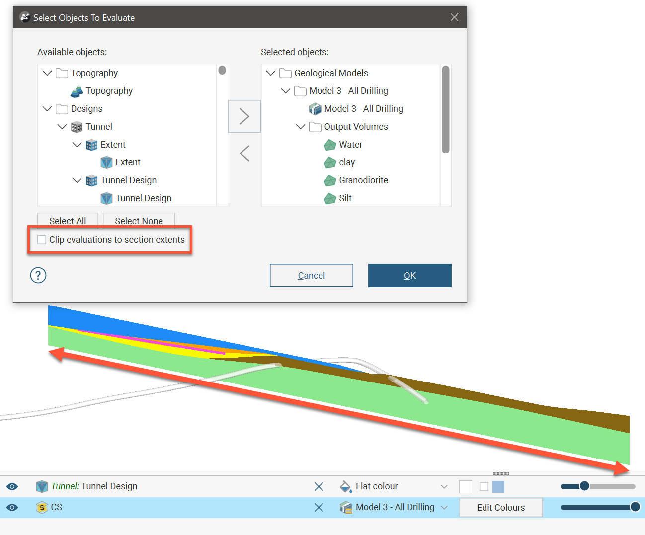

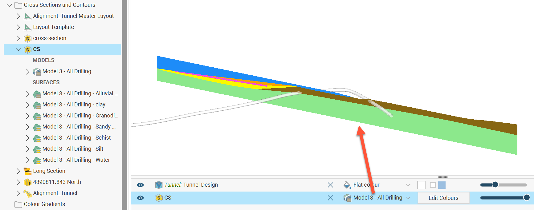

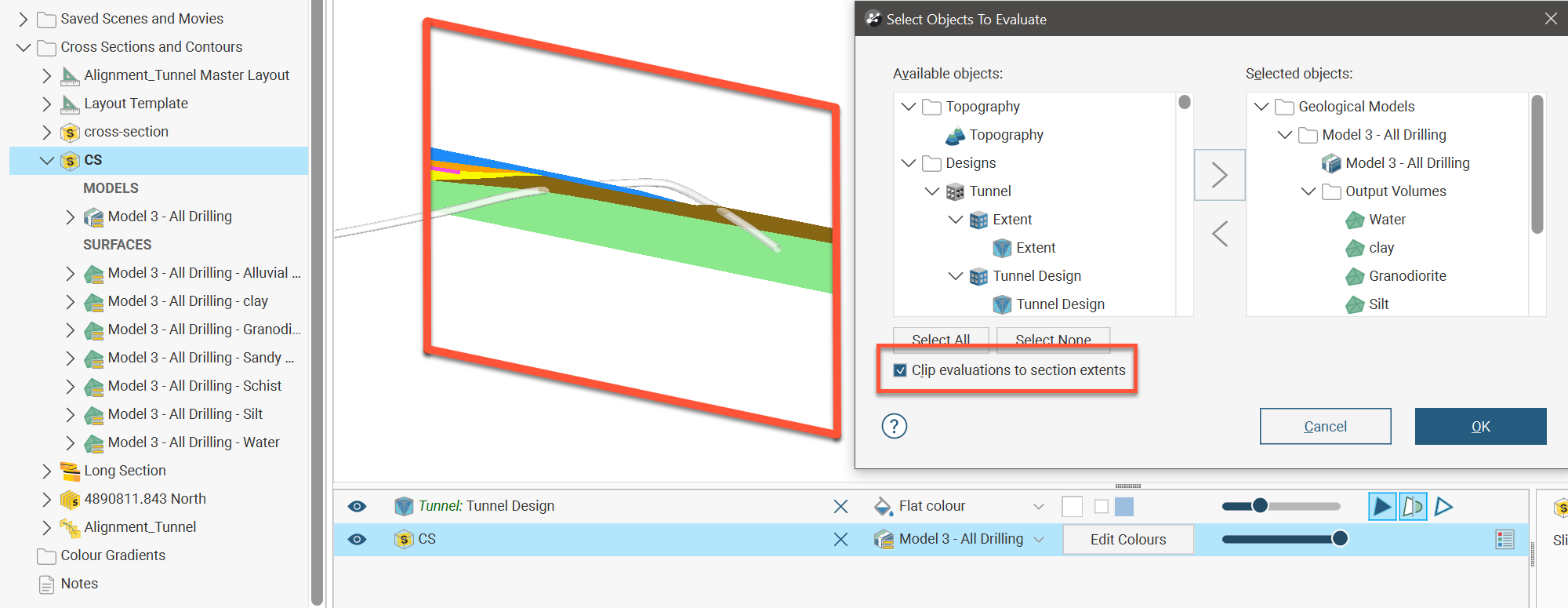

When evaluating objects on sections, you can limit the evaluation to the section extents. To do this, enable the Clip evaluations to section extents option when selecting what objects you are evaluating. This will ensure that the section appears in the scene at the same dimensions as specified when the section was defined.
When Clip evaluations to section extents is unticked, the evaluation will continue along the plane of the section to the extent of the evaluated object.

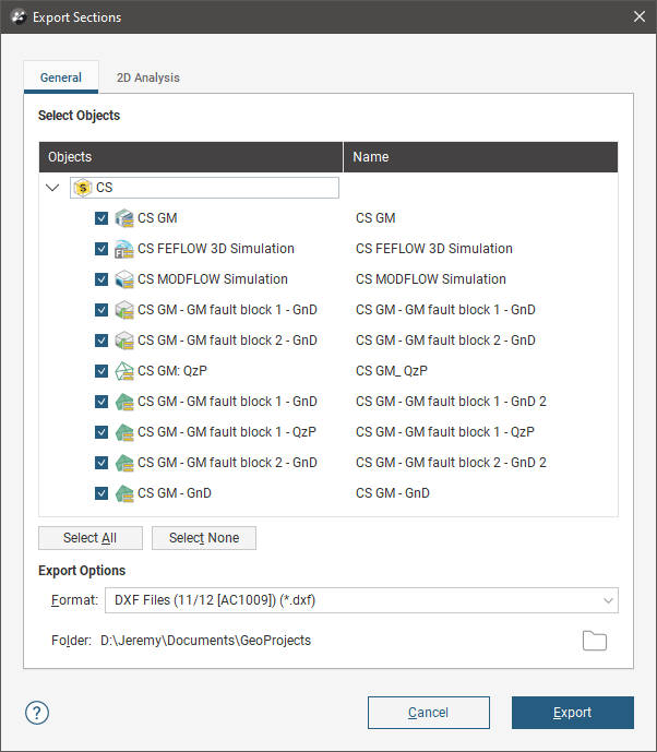

Exporting a section as a DXF file (*.dxf) exports a series of DXF lines created from the intersection of the evaluation volumes and the section plane. The lines generated from each volume are saved as separate layers in the file.
For serial sections, the section will be exported in a single file with a collection of DXF lines based on intersections between the selected evaluation and the section planes.
To export a section in one of these formats, right-click on the section in the project tree and select Export. In the window that appears, select the evaluations you wish to export with the section:
If you wish to change the name used for exporting one of the evaluations, double-click on its name, then enter the new name.
