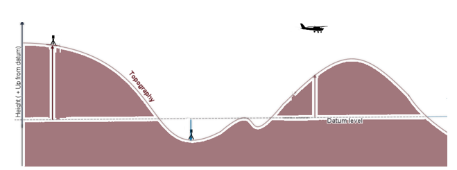

The free air correction only accounts for the difference in the elevation relative to the datum level. The topographical variation (presence of hills and valleys), however, affects the gravitational attraction. The Bouguer anomaly corrects the free air anomaly for the mass of (or lack of) rock that exists between the station elevation and the spheroid. In the case of airborne surveys, this is not the aircraft elevation but rather the DEM elevation above the datum level (Figure 1).

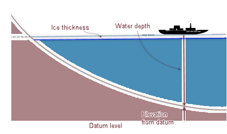

Furthermore, if the survey is conducted over water and/or ice, the Bouguer correction would take into account the water depth and the ice thickness. You are not prompted to provide the water and/or ice channel names. Instead, if the channels "Water" and/or "Ice" are present in the database, they are used in the Bouguer calculation. These two channels define the vertical distance (positive down) between the survey level and the topography (contact between rock and water) at the gravity station. Note that the "Water" channel contains the water depth at the gravity survey station location and that the ice thickness is included in the water depth. See Figure 2 below.
For shipborne surveys, if the datum coincides with the sea level (the Geoid), the water depth would be equivalent to the elevation and there would be no contribution to the Bouguer correction from the Earth' density below the datum. However, if the survey is conducted on a lake whose surface is different from the sea level (the Geoid), both the water and Earth densities contribute to the Bouguer correction component.

Figure 1: Schematic illustration of elevation channels and direction
Figure 2: Schematic illustration of relation between elevation from Datum and water depth/ice thickness
