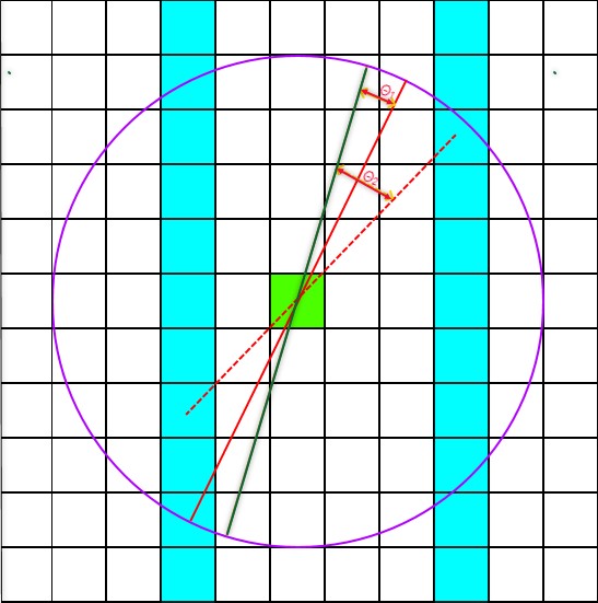

    Theta
    To explain the effect of Theta, we refer you to Figure 1 below. In this schematic, the observed data is in cyan and the point being evaluated is indicated in light green. The observed values used for the evaluation reside within the search radius (purple circle) around the green cell. The original trend direction, determined by the structure tensor, is shown by the green solid line.
    If the trend line does not intercept real data within the search radius, the trend is shifted by Theta (Θ1 on the schematic) to the direction indicated by the red solid line, and the search for real data is attempted again. In the illustration, the solid red line intercepts valid cells on one side, and the general trend is slightly shifted and honoured.
    However, if Theta is large (Θ2 on the schematic), data along the dashed red line would be analyzed. This may deviate too much from the desired linear trend and connect trends that don’t belong together.
    It is recommended to set the angle relatively small to stay within the general trend direction determined by the structure. Note that a very small angle may increase the number of iterations and make the gridding process slower.
    Figure 1: The blue cells contain real data; the green cell is the cell being evaluated; the purple circle is the search radius.
