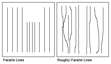

The Bi-directional gridding method (BIGRID) is a numerical technique for gridding parallel survey lines or roughly parallel lines, as illustrated in the figure below.
Data distribution suitable for bi-directional gridding BIGRID is the only gridding method that can take advantage of a strong line-to-line correlation of otherwise narrow features in line data; it joins narrow features that extend from line to line perpendicular to the line direction. BIGRID is ideal in these situations, especially if there is a high sample density down the lines relative to the line separation. The method cannot be applied to randomly distributed XYZ data. Line data that is measured along orthogonal lines is also not well suited to BIGRID: the method does not use tie lines; if data on the tie lines is important, minimum curvature or kriging should be used. This gridding method uses linear, minimum curvature, or Akima splines to interpolate grid nodes between lines in the direction of the overall trend of the data, which is usually perpendicular to the survey lines. In addition to trend enhancement, bi-directional gridding allows the method of interpolation to be selected independently for the down-line and across-line directions. Geological trends in the data can be emphasized by the appropriate orientation of the grid so that the across-line interpolation is in the direction of the trend. BIGRID can be 10 to 100 times faster than the minimum curvature gridding (RANGRID), and up to 1000 times faster than kriging (KRIGRID). BIGRID has the following strengths and features:

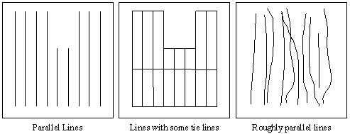

Use bi-directional gridding (BIGRID) if the data is collected along lines that are roughly parallel, as in the following examples:
BIGRID is ideal in these situations, especially if there is a high sample density down the lines relative to the line separation. Furthermore, BIGRID is able to join narrow features that extend from line to line perpendicular to the line direction.
BIGRID is not able to use the tie lines, as shown in the middle example, because of the way the gridding algorithm works. If the data on the tie lines is important, minimum curvature gridding (RANGRID) or kriging (KRIGRID) should be used.

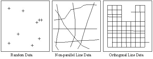

Use RANGRID, KRIGRID, or TIN Gridding (TINNING) when the XYZ data is not sampled along lines that run in roughly the same direction. Such data are often called random because they give a random appearance when the data locations are plotted. Also, line data with survey lines that are orthogonal (or have random directions) should be gridded with RANGRID, KRIGRID, or TINNING. The following figure illustrates these types of data:
If the data is relatively smooth between sample points or survey lines, then RANGRID should be used.
