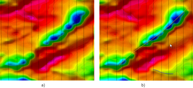

    Spline down line
    Geological trends in the data can be emphasized by the appropriate orientation of the grid so that the second interpolation is in the direction of strike. In addition to trend enhancement, BIGRID allows the method of interpolation to be selected independently for the down-line and across-line directions.
    Select from one of the interpolation methods available: linear, cubic spline (minimum curvature), Akima spline (default), or "Nearest neighbour".
    For data that is sampled at a high density relative to the grid cell size, such as is often the case for airborne data, linear interpolation is usually sufficient for the down-line spline and will produce some saving in computation time.
    Script Parameter: BIGRID.ISP1
    Spline across line
    Select the across-line interpolation method as "Cubic", "Akima", "Linear" or "Nearest neighbour". The default is "Akima".
    In cases where the data contains rapid changes in gradient, the minimum curvature (cubic) spline may produce undesirable highs or lows in the final grid. This most commonly occurs across lines with poor line-to-line correlation of the data. The Akima spline method does not suffer as much from this problem, although it does tend to produce sharper corners around actual data points and the resulting grid tends to be less smooth.
    Script Parameter: BIGRID.ISP2
    Trend angle
    Specify the trend angle measured counter-clockwise relative to the positive X-axis (deg ccw from +X)image\ebx_1610156733.jpg.This parameter is intended to enhance geological features in the direction specified.
    If the trend angle is not specified, the default is to calculate the angle perpendicular to the survey line direction.
    See the Application Notes for more details on specifying the trend angle.
    Script Parameters: BIGRID.TRA

    Optimizing Bi-Directional Line Gridding with Oblique Survey Lines
    The trend angle is intended to enhance geological features in the direction specified. Since ideally you want to enhance features perpendicular to the survey line direction, you should specify this angle to be perpendicular to the line direction. Note that the angle to be specified is counter-clockwise relative to the positive X-axis (which normally points to the east).
    If the line direction is very close to either north-south or east-west, BIGRID’s default settings are ideal. If the survey lines are at other angles (not in the north-south or east-west orientations), you should override the default BIGRID settings to avoid odd streaking or other non-geological results. For example, if your survey lines are oriented at N30E, specify a trend angle of either –30 degrees or 150 degrees. If your survey lines are oriented at N45W, specify a trend angle of 45 degrees. This approach will also enhance geological trends perpendicular to the line direction.
