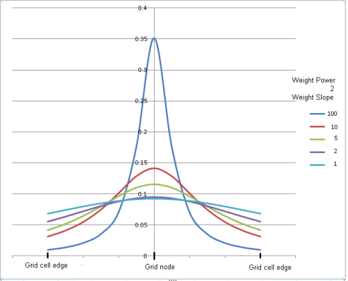

If the weighting slope is set to zero, neither weighting power nor weighting slope are used after the initial coarse grid has been processed. No weighting is performed on subsequent refined grid iterations, and only the data point nearest to a grid node affects the parameter value assigned to that node.
If the data has been collected along traverse lines, it is recommended to set the slope (S) as the number of grid points between the traverse lines.
The greater the value of the weighting slope setting, the more the weighting falls off according to the weighting power alone. Setting the weighting slope to a value greater than 0 is suitable for anisotropic datasets. For instance, in aeromagnetic survey data with a line spacing of 200 metres and readings every 5 metres along the line, the 50 metre cell size block will include a large number of real data points to be combined into one weighted location and z value; in such case, setting the weighting slope to 5.0 will produce a smoother non-aliased outcome relative to a setting of 0.0.
Normalized weight curves W = 1/(D p+S -1)

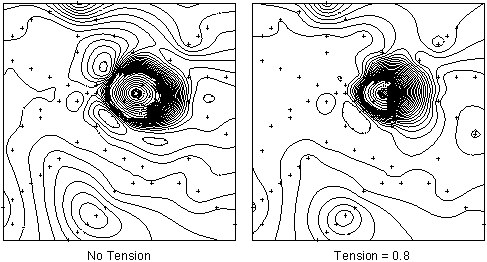

Apply Internal Tension
Minimum-curvature surfaces can be viewed as elastic plate flexures; they approximate the shape adopted by a thin plate flexed to pass through the data points. Minimum-curvature surfaces may have large oscillations and extraneous inflection points in sparsely sampled regions. These extraneous inflection points can be eliminated by adding tension to the elastic-plate flexure equation; thus improving the convergence of the iterative method of solution for the gridding equations. If you notice localized highs and lows in areas of sparse coverage, you would have to increase the tension to eliminate this artefact of gridding.
Overshoot in unconstrained areas
In general, overshooting in unconstrained areas may be a result of one of:
1. A poor minimum curvature solution
The minimum curvature solution may be far from an ideal fit if the starting or coarse grid was not a good approximation of the final grid, or the XYZ data set contained too few points to rapidly pull in the grid during the iteration process. To compensate for this, reduce the tolerance (tol) and, if necessary, increase the number of iterations (itrmax).
2. A good minimum curvature solution
In situations of uneven spacing or insufficient sampling of features, minimum curvature gridding tends to overshoot the observed data points and produce anomalous highs or lows between observation locations. Although this is mathematically ideal and, in some cases, more desirable, it is often the result of poor sampling. The minimum curvature gridding includes the ability to reduce overshoots by the application of internal tension as described by Smith and Wessel (1990). Tension can be thought of as adding springs to the edges of a flat sheet that is forced to go through each data point. If the springs have no tension, a minimum curvature surface results. Increasing tension on the springs begins to flatten the surface such that each data point becomes to a 'tent pole' over which the surface is stretched. Infinite tension produces a straight line in the surface between data points.
The effect of tension on some simple random data is shown in the following figure:
Although the application of internal tension can reduce or eliminate overshoot, it does cause the curvature of the surface to increase in the vicinity of the data points. If the gridded data is to be used in subsequent high frequency processing, such as the calculation of residuals or vertical derivatives, bullseyes around data points become pronounced. Again, the only effective solution to this type of problem is sufficient sampling to allow gridding without tension.
