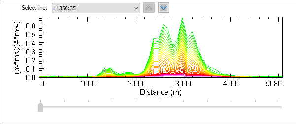

Profile view
The Profile view displays the data distribution based on your channel(s) selection, scaling options, and current database line selection.
The X-axis units are converted from the database into distance units.
The Y-axis units are defined from the selected channel(s) and are printed as the profiles axes titles: first channel to the left and second channel to the right of the graph.

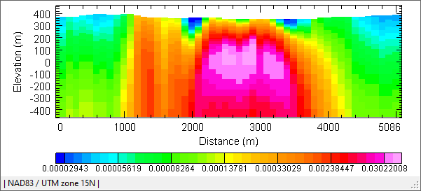

Model view
The Model view displays the data distribution based on your voxel file selection, depth clipping options, and current database line selection.
The depth is represented on the Y axis in the coordinate system spatial units of the voxel (e.g., meters, feet).
The distance units on the X axis are retrieved from the database coordinate system, and not from the voxel.

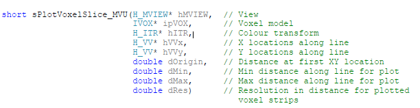

The CMVU.PlotVoxelSlice wrapper calls the internal sPlotVoxelSlice_MVU function, found in the geoengine.map solution in the mvu\voxel_slice.cpp code file.
This is the function header with parameter descriptions:
The function works as follows:

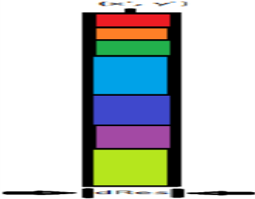

  2. Plotting inside a map view must be done as a finite “vertical” rectangle or strip, e.g. with a min and max X; there is no concept of a “pixel” in a map view. “dRes” thus gives the width of each strip, and each strip is plotted centered at the distance “d” (the X-axis value in the map view) corresponding to each line path (X, Y) location.
  3. It is assumed that each horizontal cell in the voxel has a unique set of values below it, so when proceeding through the list of input (X, Y) locations, those consecutive locations which are found to share the same vertical voxel column are collected together and plotted as a single “wider” rectangle for the sake of efficiency.
  4. If your input “dRes” value was too small, you would get white space gaps between strips on the map, and if it was too wide, they would overlap and obscure each other. The “dRes” value is chosen to make a filled plot corresponding to single pixels in the resulting 2D section voxel plot window. (Note that in the actual plot there are no black border lines).
  5. The MVIEW function was created for this very purpose: to plot a “PixelStrip”, e.g. a vertical rectangle with a vertical set of different-coloured rectangles:
