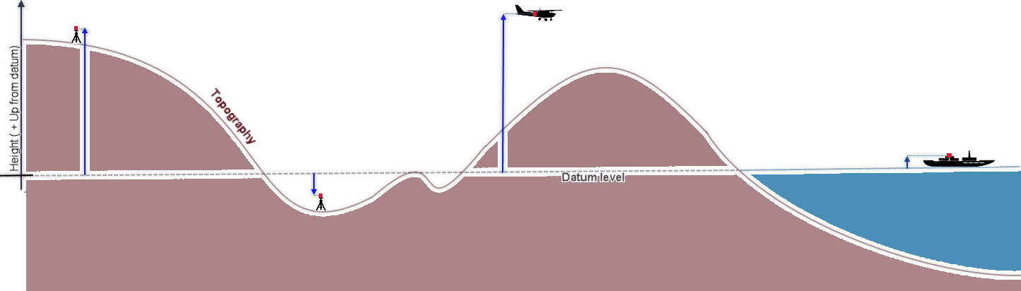

  • For ground surveys this is the elevation of the sensor, which equates to the topography plus the instrument height. However, if you have already applied a height correction in Gravity Corrections, then the elevation should represent the height of the topography above the datum (generally the geoid or sea level).
  • For airborne surveys at a constant barometric height, a free air correction is not necessary because the gravity values are at the same height. Nonetheless, you may want to reduce the data to the geoid surface in which case you could apply the free air correction. For drape airborne surveys, provide the flight elevation above the datum (positive up) . For drape surveys, if you have already applied a height correction, the elevation should represent the height of the topography to which you height-corrected the data.
  • For shipborne surveys, normally the elevation is constant and a free air correction is not necessary.
        Figure 1: Height (elevation) relative to datum level.
