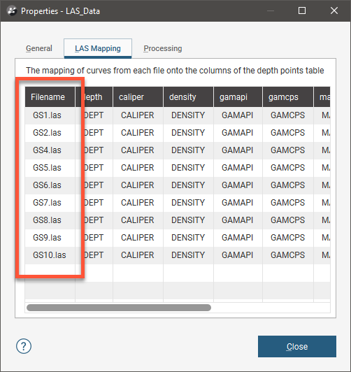

LAS File Mapping
The Properties window for LAS Boreholes includes a LAS Mapping tab that shows what data files have been used for the selected borehole:
This is useful when data for a borehole originates in different files.

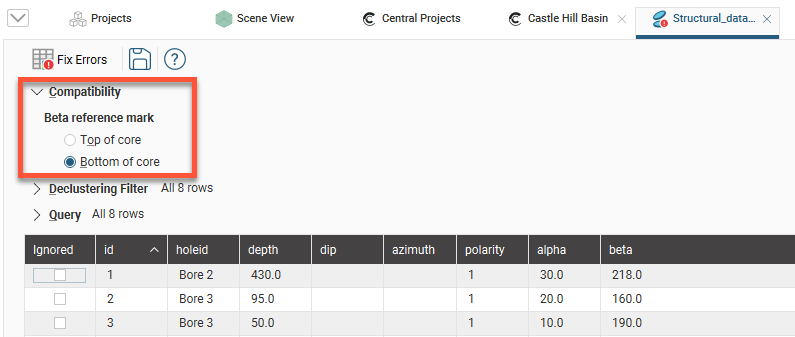

Leapfrog Works expects columns describing the borehole identifier, the depth and the structural orientation. Structural orientation can be specified using either dip and dip azimuth or alpha and beta.
Match the values in the file to the required column headers, then click Finish to import the file. The table will appear in the drilling dataset.
If the structural orientation is specified using alpha and beta, the reference line from which the beta is measured can be the bottom or top of the borehole. When the table is imported, the default setting is Bottom of core. To change this, double-click on the structural data table in the project tree. Next, click on Compatibility to change the Beta reference mark setting to Top of core:
