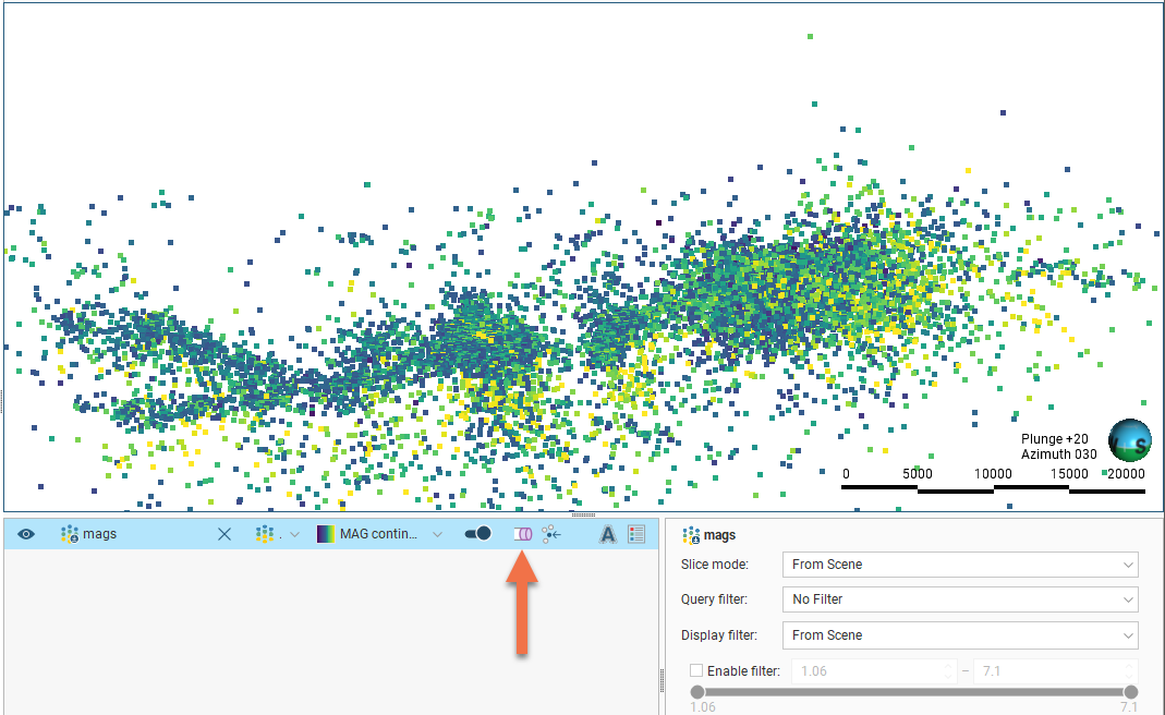

Displaying Points
Points data can be displayed using a single flat colour, using a colour gradient or using the points values. You can also import a colourmap, which is described in Colour Options.
As with boreholes, points data can be displayed as flat points or as spheres. When Make points solid button (
) is enabled for points data, the data points are displayed as spheres. Here, the values are displayed as flat points:
You can restrict the range of values displayed using the Display filter in the properties panel.

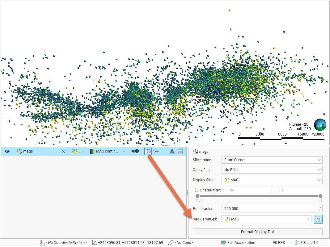

When using the spheres option, the points can be displayed using the values from any column in the points table. To do this, select a column from the Radius values list in the properties panel:
The Point radius setting then determines the maximum point size displayed in the scene.

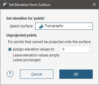

Setting Elevation for Points
You can set the elevation for imported points tables by projecting them onto a surface. This overwrites elevation values in the z column of the imported points table, using the data from the selected surface. If the surface does not intersect vertically with all points, you can choose how the z values for those unprojected points will be handled.
Derived points cannot be projected onto a surface to set the point elevation.
To set the elevation for points from a surface, right-click on the imported points object in the project tree and select Set Elevation. The Set Elevation window will appear:
Next, select how unprojected points should be handled. There are three options:
- Leave elevation values empty clears the z values for all unprojected points.
- Leave unchanged makes no changes to the z values for unprojected points.
