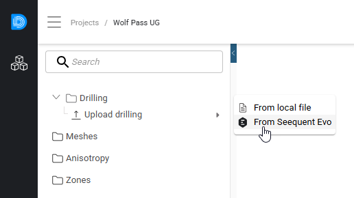

To upload drilling data into a Driver project from Seequent Evo, click on the button to the right of Upload drilling and choose From Seequent Evo:

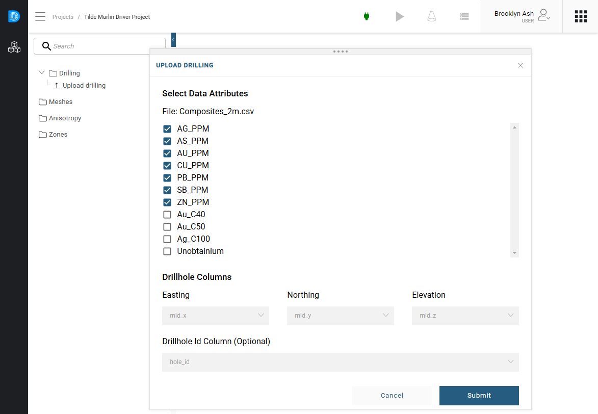

Next, choose the attributes you wish to import. Here, the attributes AG_PPM and AU_PPM are selected:
Click Submit to import the data.

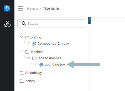

Driver creates a single closed mesh called a bounding box that encloses all samples in a project. When you add drilling data to a new project, the bounding box is added to the Meshes > Closed meshes folder:

To upload drilling data into a Driver project from a local file, click on the button to the right of Upload drilling and choose From local file. In the window that appears, navigate to the location on your hard drive where the file is stored and select it.

The process for uploading drilling data is the same as for uploading from Seequent Evo, except that when choosing the attributes you wish to upload, you also need to map the X, Y and Z columns. A drillhole ID column is optional.
Once you have selected attributes and mapped the required columns, click Submit.

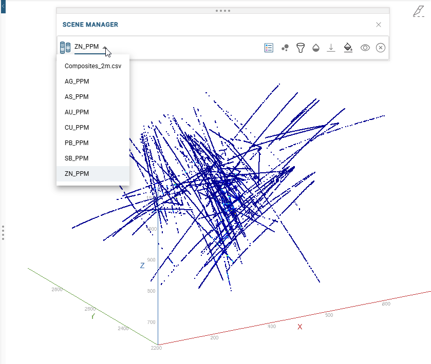

Displaying drilling data
When displaying drilling data in the scene, you can colour the data using any of its columns:

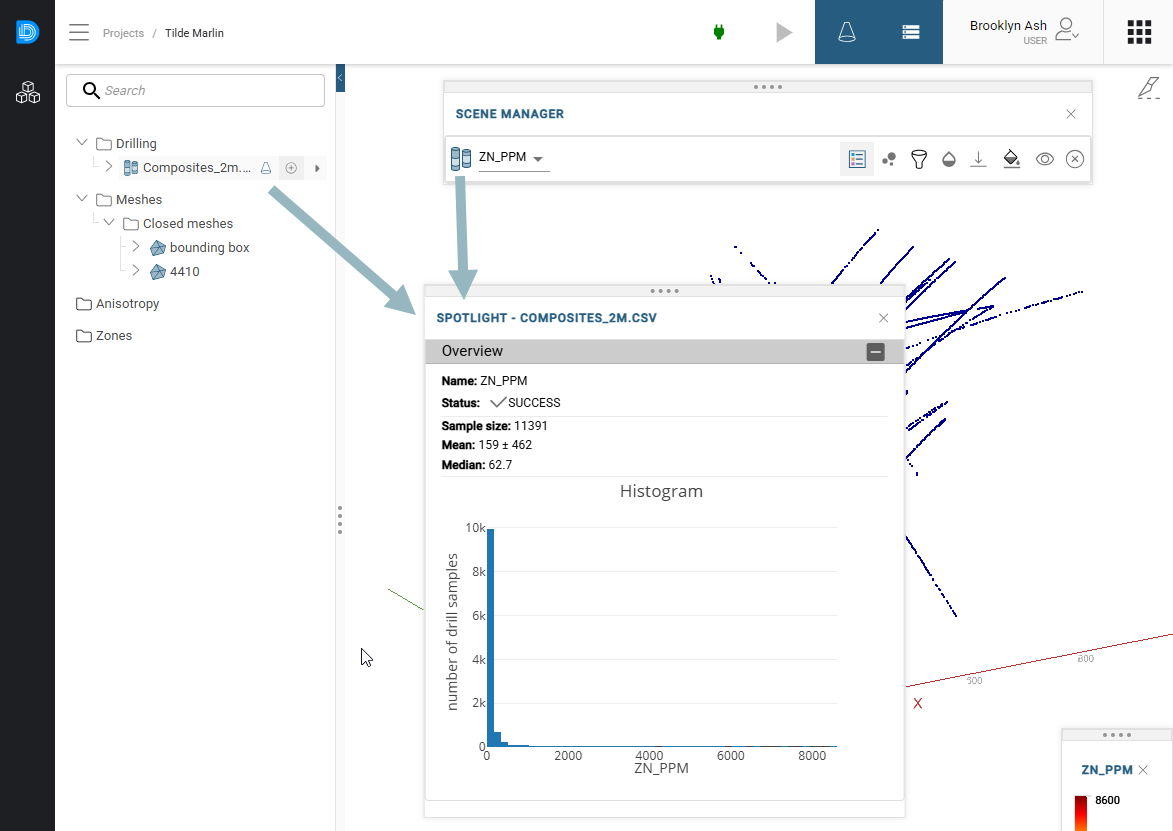

Drilling spotlight
Opening the spotlight for a drilling data object will show some basic summary statistics, along with a histogram of the value distribution:

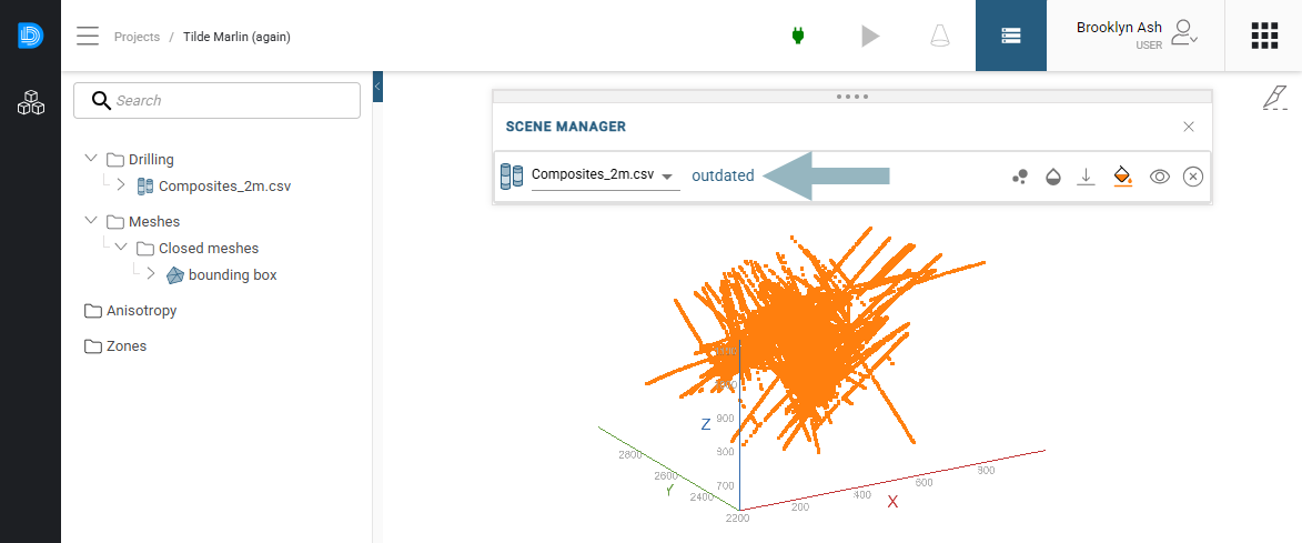

Updating drilling data
When new data becomes available outside your Driver project, update the project by selecting one of the Update drilling options:
Whether you are updating from Seequent Evo or from a local file, you will be prompted to choose the file to use. Once you have done so and chosen which columns to include, click Import. All data objects in the project will be reprocessed.
