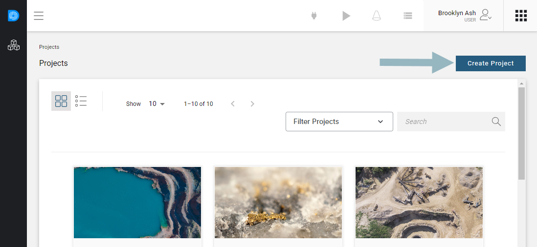

To create a new Driver project, click Create Project in the Projects list:
In the window that appears, enter the project’s name and a description.
Next, choose what workspace the Driver project will belong to.
You cannot change the workspace a Driver project belongs to once the project has been created, although you can edit the project’s name and description.
If there is already data in the selected workspace, you can add it to the project by enabling From Seequent Evo and choosing which data object you wish to use. It is not necessary to do this, as you can also add data to the project once it has been created.
Click Create to create the project.
The new project will open and you can begin working in it.

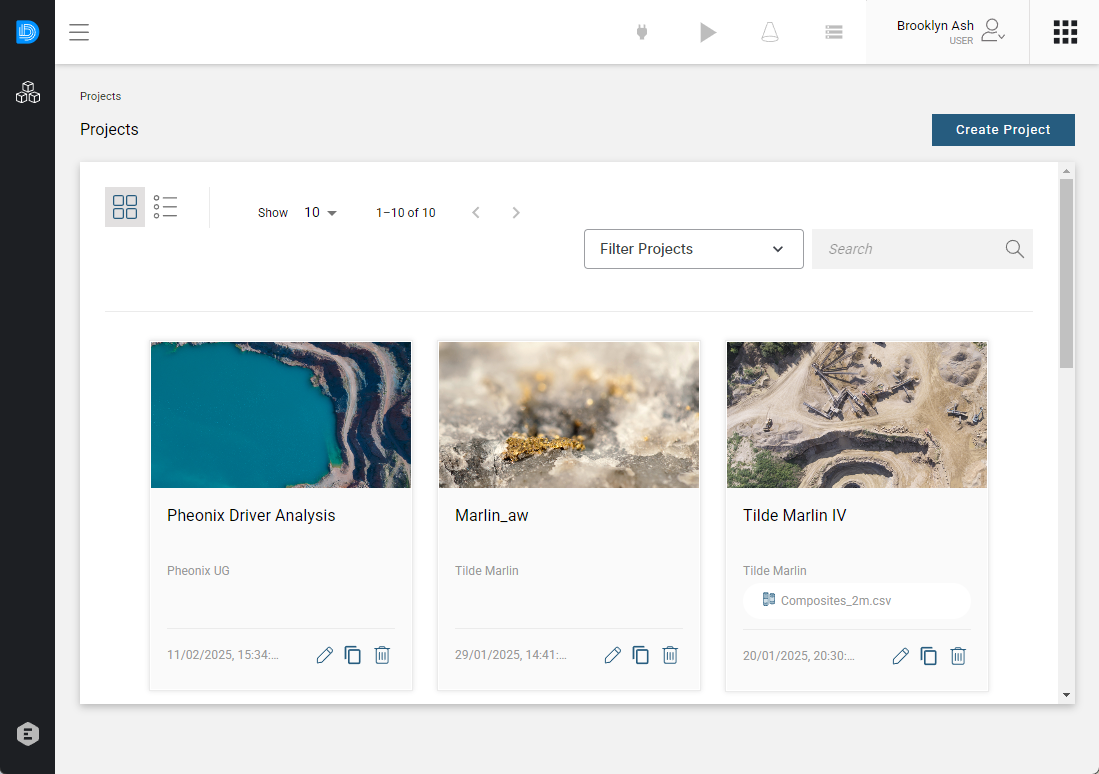

Copying a Driver project
If you already have a Driver project in a specific workspace, you can make a copy of that project in the same workspace. To do this, open the Projects list and click on the copy button (
) below the existing project’s thumbnail:
Enter a name and description for the copy of the project, then click Create.
The copy of the project will be added to the projects list.
Copied Driver projects are static copies and any changes made will not update previous versions.

Editing Driver project properties
You can edit the name and description for an existing Driver project, but you cannot change what workspace it belongs to.
To edit the name and description, open the Projects list and click on the edit button (
) below the project’s thumbnail.
Update the name and/or description, then click Save.
Deleting a Driver project
Once deleted, a Driver project cannot be restored.
To delete a Driver project, open the Projects list and click on the delete button (
You will be asked to confirm your choice.
