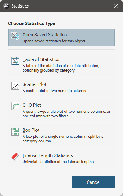

For many of the data tables, charts and tables of statistics present statistical information about the data set. To create one of these statistics reports, right-click on a data table; if the data type has associated statistics options, the menu will include a Statistics option.
When that Statistics option is selected, a window will appear where the statistics type can be chosen:
The button at the top of the window is Open Saved Statistics; this will open a window with a collection of the already saved statistics for the current data object. If there are no saved statistics for the data object, the button will be greyed out.
The options available for creating statistics reports will depend on the current data type. Selecting an option opens a new statistics window. Separate topics describe the different statistics visualisations available in Leapfrog Geo:

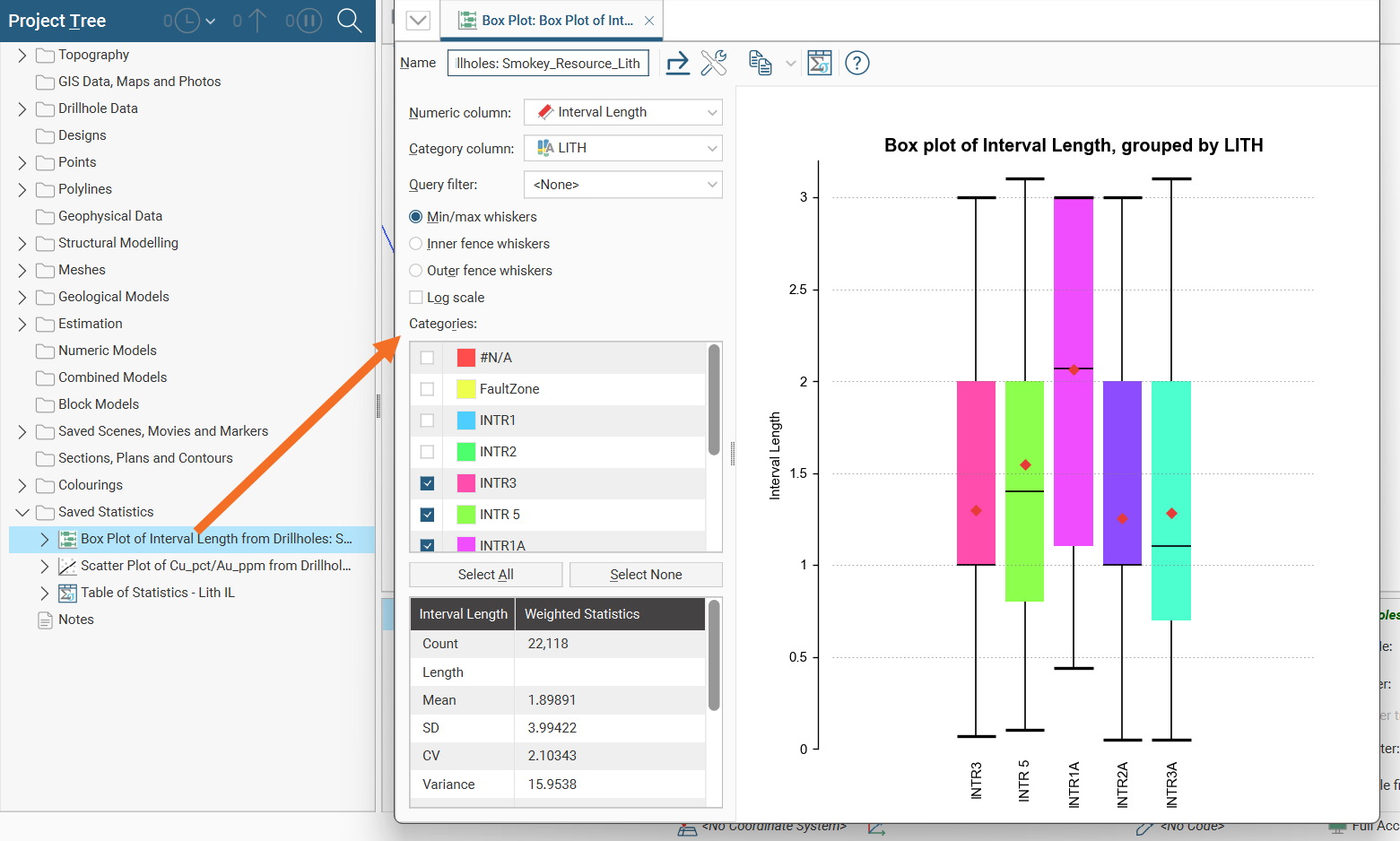

Managing Saved Statistics Reports
The Saved Statistics folder in the project tree contains charts and tables you have defined for data in the project. These can be organised into sub-folders. Each saved statistics report will also have a link to its source data object.
Each of the statistics objects in the Saved Statistics folder can be opened and will appear as a detachable tab.

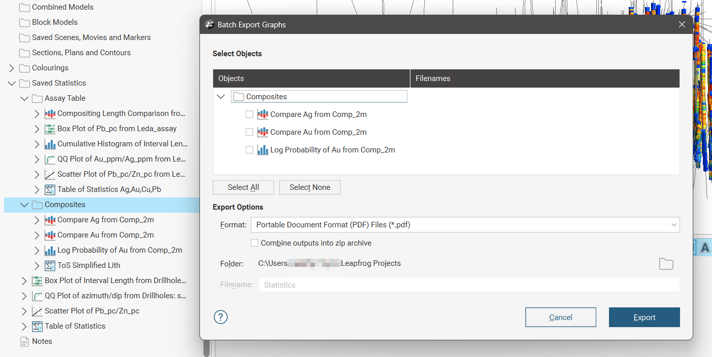

You can also bulk export saved statistics reports by right-clicking on the Saved Statistics folder or any subfolder and selecting Export Graphs.
In the Batch Export Graphs window, the Select Objects list will include all the charts in the selected folder.
Tables of statistics will not be included in batch exports.
Select any of the statistics reports you wish to have included in the export. There are Select All and Select None buttons to assist.
Selected objects are given a default filename that is the same as the object, but this can be modified in the Filenames column, if required.
Choose the Format for the files to be exported and the Folder location. There is also an option to Combine outputs into zip archive that will produce a single *.zip file with the given Filename containing all the exported reports.
