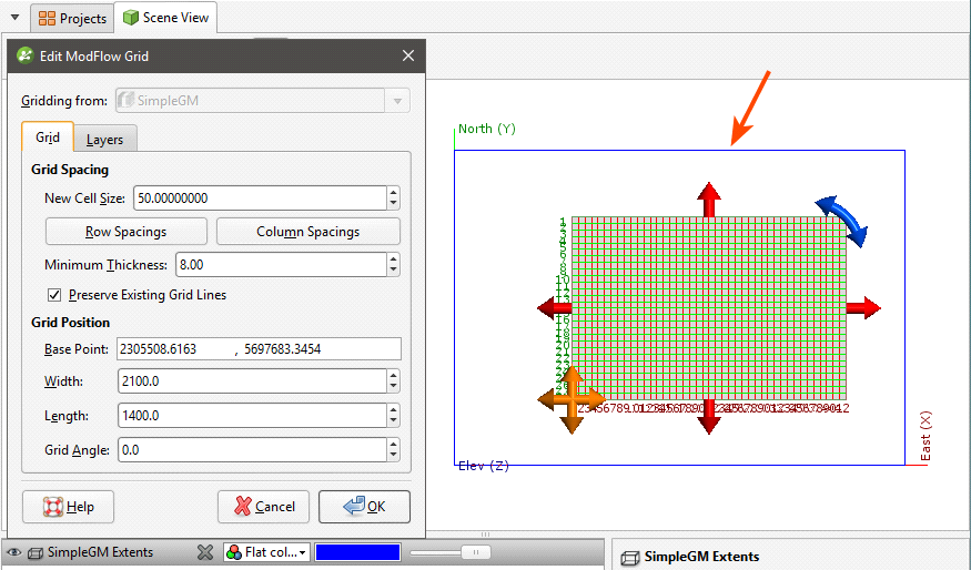

First, we need to reduce the area that uses the cell size of 50 by using the red handles in the scene:
The blue box in the scene is the geological model extents for the model used to define the ModFlow model and represents the unedited boundary of the ModFlow model.

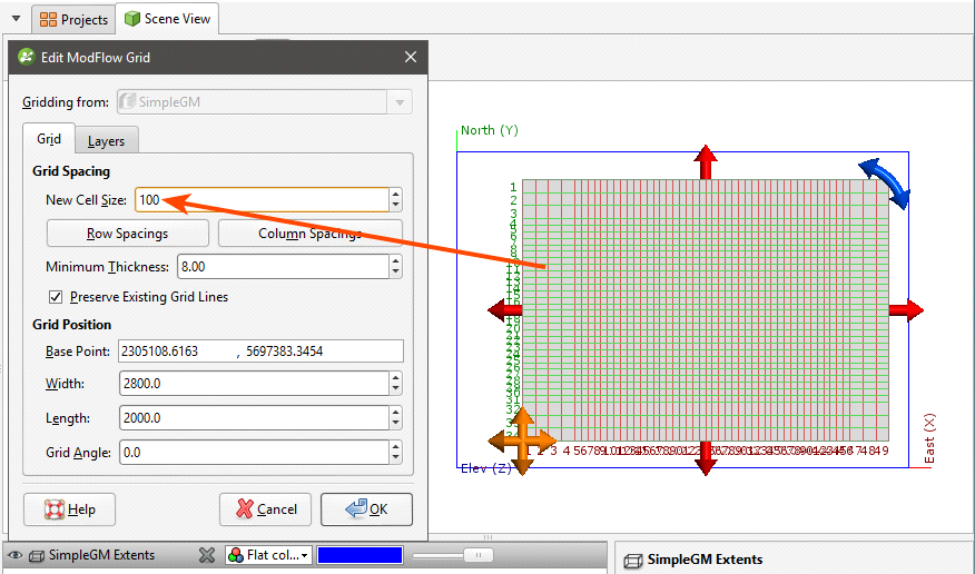

Next, enter the cell size to use for the area adjacent to the 50.0 cells in the New Cell Size field. Then, drag the red handles to enlarge the grid. The centre part of the grid is still set to 50, while the new area is set to 100:
If the Preserve Existing Grid Lines option is enabled, grid lines for cells already defined will not be moved to account for new cells.

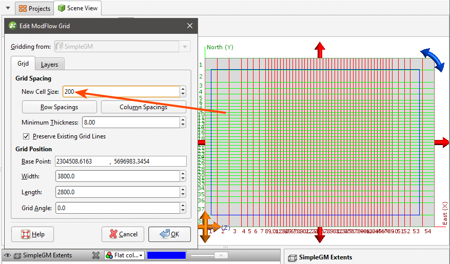

Enter the next cell size in the New Cell Size field and then use the handles to enlarge the grid again:
Click OK to update the grid.
