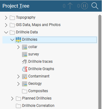

Once data has been added to the project, a Drillholes object will be created that serves as a container for the tables imported:
You can open each table by double-clicking on the table (
). The table will be displayed and you can make changes. See Working With Data Tables. When there are errors in the data, the relevant table will be marked with a red exclamation mark (
). See Correcting Data Errors in Leapfrog Geo for more information on fixing drillhole data errors.

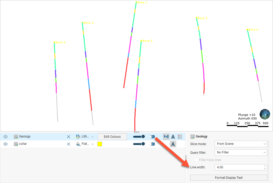

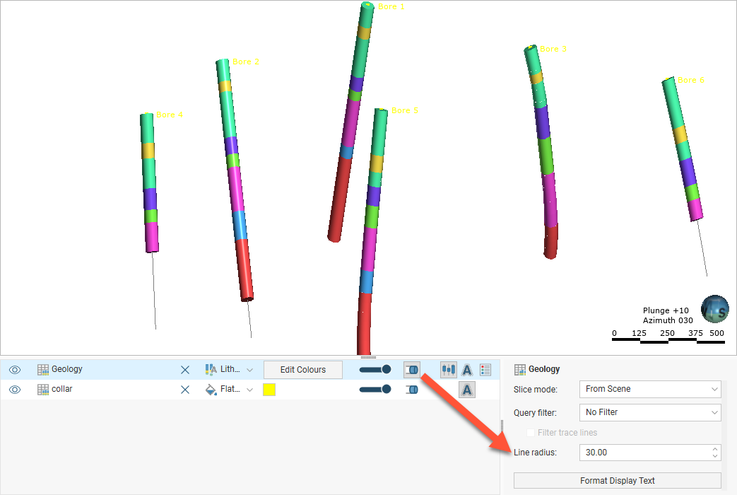

Displaying Drillholes as Lines or Cylinders
You can display drillholes as lines or cylinders. You can also display the data associated with each segment. Here, the drillholes are displayed as flat lines:
The width of the lines is set in the shape properties panel.
When the Make lines solid button (

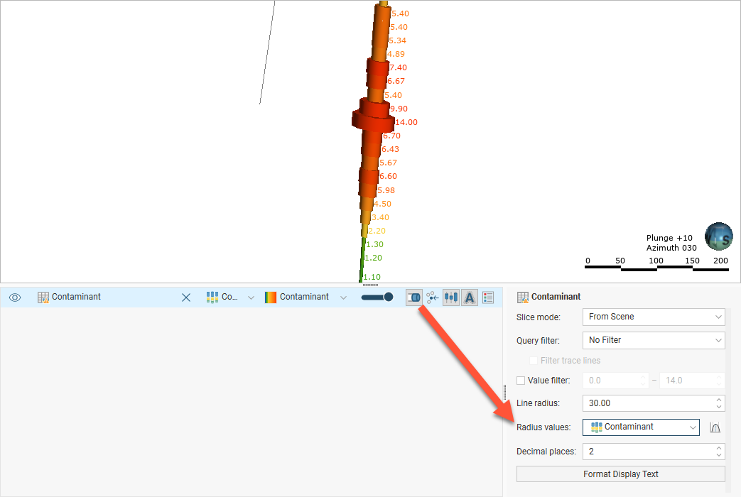

) is enabled, the drillhole data is displayed as cylinders and the property that can be controlled is the Line radius:
When numeric data is displayed, there is an additional option, to use a data column in the table for the cylinder radius:
When the log button (
) is enabled, the log of values is used for the radius.

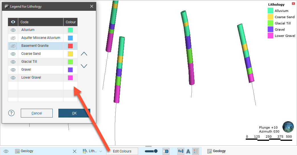

When lithology tables are displayed, you can hide some of the lithologies to help make better sense of the information in the scene. Click on the Edit Colours button in the shape list. In the window that appears, use the Show/Hide buttons (
) to determine what segments are displayed:
To select multiple lithologies, use the Shift or Ctrl keys while clicking. You can then change the visibility of all selected lithologies by clicking one of the visibility (
) buttons.

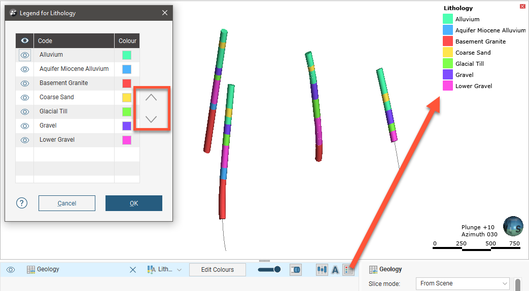

Displaying a Legend
To display a legend in the scene, click the Show legend button (
) for the table:
The legend in the scene will be updated to reflect lithologies that are hidden in the scene when you click Edit Colours and hide some lithologies.

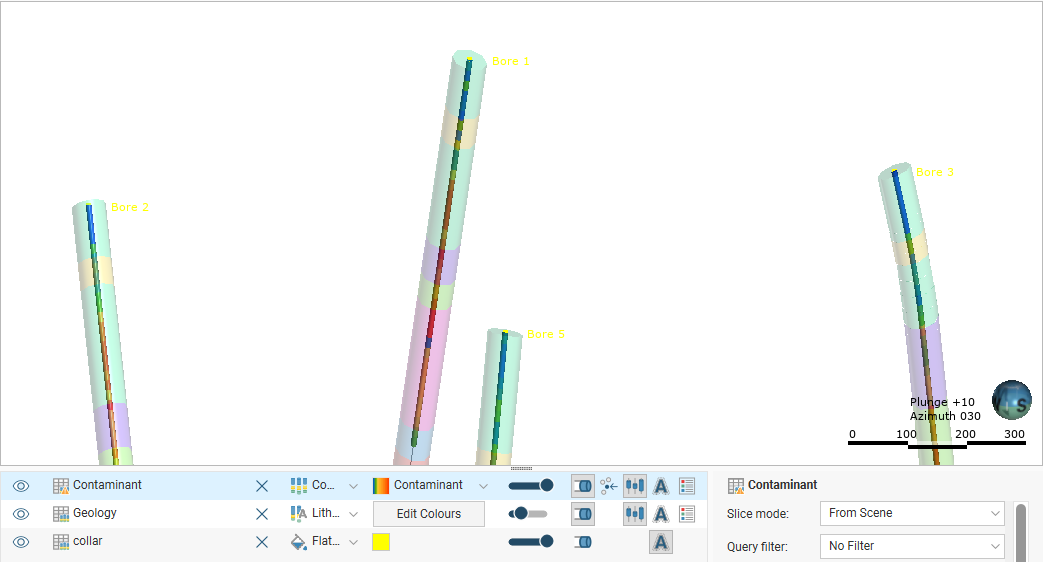

Viewing Multiple Interval Tables
When viewing multiple interval tables, use the line and point size controls and the transparency settings to see all the data at once. For example, here, the geology table has been made transparent to show the contaminant intervals inside:

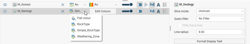

Selecting from Multiple Columns
When an interval table has more than one column of data, select the column to view from the view list:

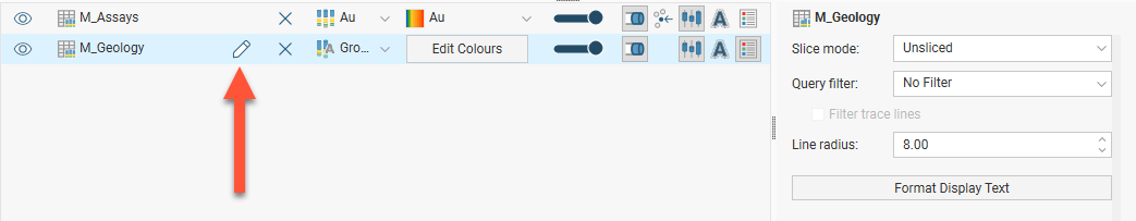

Some columns are editable, in which case you can click on the Edit button (
) to start editing the table:

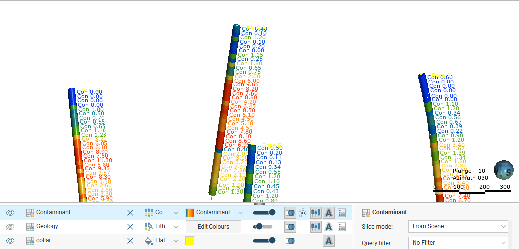

Displaying Interval Data in the Scene

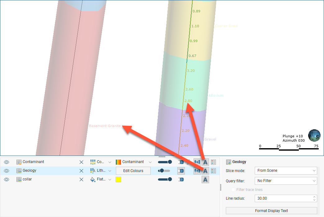

Drillholes can be displayed with the data associated with each segment. For example, in the scene below, contaminant values are displayed along the drillhole:

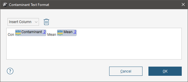

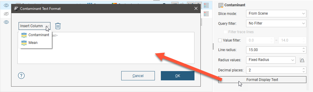

To view data in this way, select the table in the shape list, then click on the Format Display Text button. In the Text Format window, click Insert Column to choose from the columns available:
You can display multiple columns and add text:

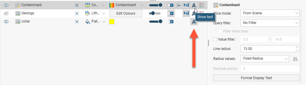

Click OK to update the formatting in the scene. You can conceal the formatting in the scene by clicking on the Show text button (
) in the shape list:
Clear text formatting by clicking on the Format Display Text button, then on the Delete button (

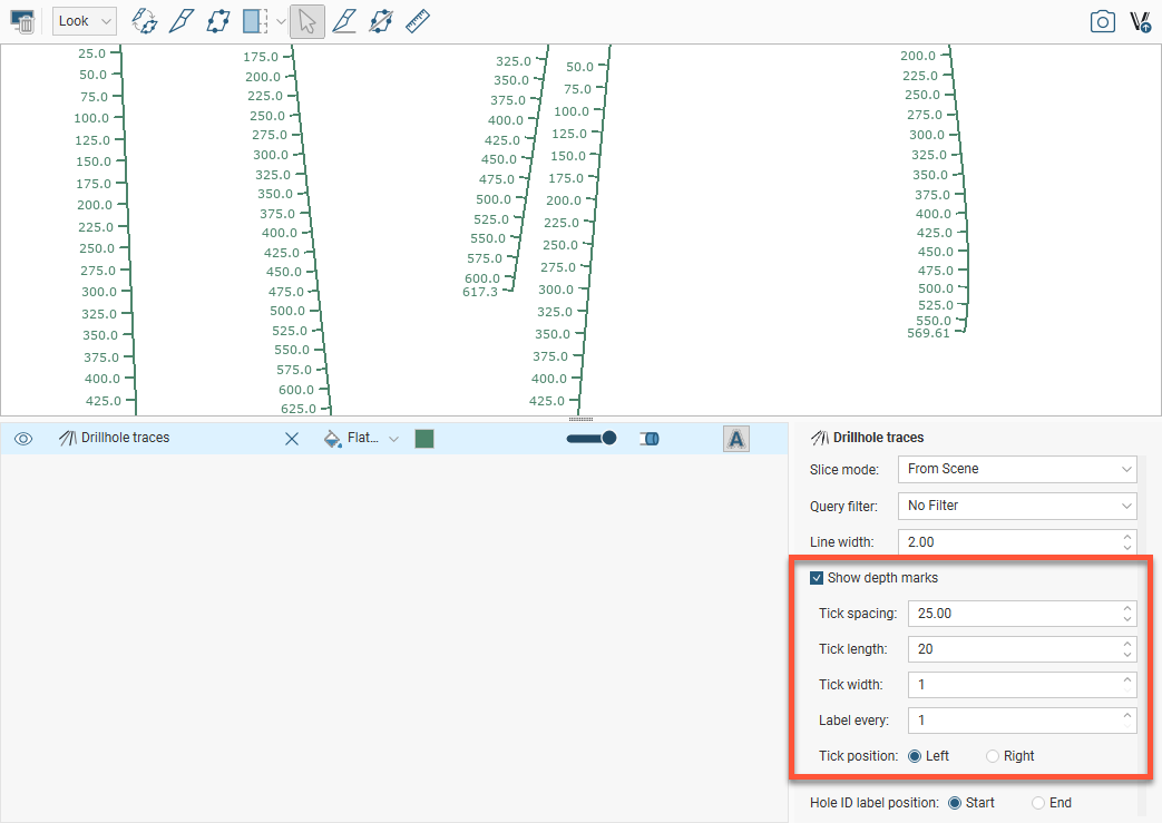

Displaying Drillhole Traces
Adding the Drillhole traces object (
) to the scene can be useful in visualising the extent of drilling. You can change the colour used to display the traces, and they can be displayed as lines or cylinders. You can also display depth markers in the scene. To do so, click on the traces in the shape list and enable the Show depth marks option:
Depth markers can be displayed with or without text. Enable the Show text option ((
)) to display the depth values. This option also displays the hole ID, which can be displayed at the start or the end of the drillhole.

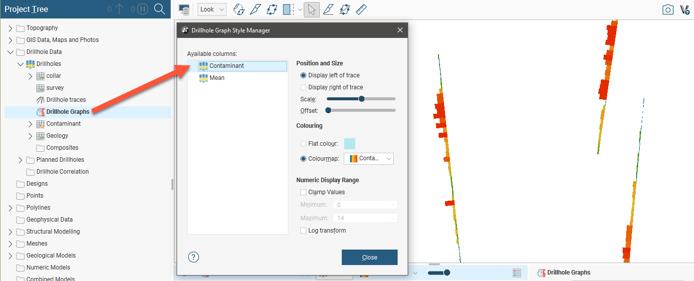

Downhole numeric data can be displayed in the scene as a bar graph and downhole points data can be displayed as a line graph. To display downhole data in this way, add the Drillhole Graphs object (
) to the scene. The Drillhole Graph Style Manager will be displayed, showing the data columns available:
Data can be displayed to the right or the left of the drillhole trace. Use the sliders to change the Scale and the Offset from the trace.
Data can be clamped, e.g. all values above the set maximum value will be set to the maximum value.
If there are negative values in the data, they will be displayed on the graph with a value of zero.
Downhole points can be displayed as a line, and you can change the Colouring, Scale and Offset of the line:

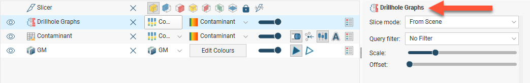

All changes made in the Drillhole Graph Style Manager are automatically updated in the scene so you can experiment with the settings. Once you have closed the window, you can also change the Scale and Offset by clicking on the Drillhole Graphs object in the shape list:
To select a different column to display, open the style manager by double-clicking on the Drillhole Graphs object in the project tree or select a new column from the shape list.
If you are working in a new project into which you have just imported drillholes, the Drillhole Graph Style Manager will open when you add it to the scene. If the Drillhole Graph Style Manager does not open when you add the Drillhole Graphs object to the scene, it is because the styles have already been set, perhaps by another user. You can change them by double-clicking on the Drillhole Graphs object.

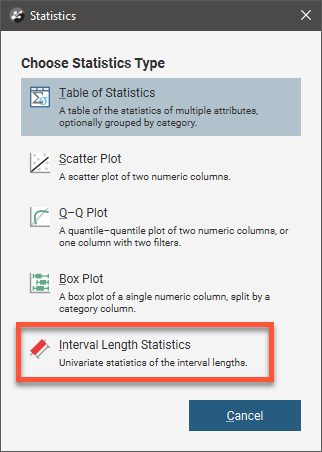

To view statistics on an interval table, right-click on the table in the project tree and select Statistics. The following options are available:
See the Analysing Data topic for more information on each option:
The Interval Length Statistics graph is a univariate graph, so for more information on the options available, see Univariate Graphs in the Analysing Data topic.
Right-click on a numeric column and select Statistics to open a univariate graph for that column.
