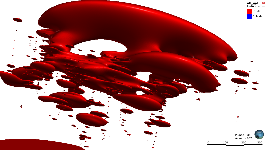

Indicator RBF Interpolant Display
Display the interpolant by:
- Dragging the interpolant into the scene or right-clicking on the interpolant and selecting View Output Volumes.
- Right-clicking on the interpolant and selecting View Isosurfaces.
You can also display the sample grouping (
) generated as part of the interpolant, which is useful in making decisions about the Cut-off value and the Iso value:

Use Volume filtering to discard smaller parts of the volumes in which you do not wish to carry out further processing. For example, this interpolant has numerous small volumes:
Enabling Volume filtering removes the smaller parts:
