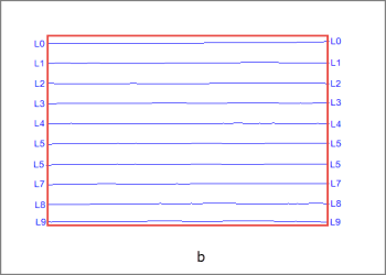

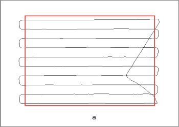

Generally, a Sortie is flown as a continuous flight, starting and ending at the takeoff point. This data should be split into parallel lines. The travel to/from the takeoff point and the turnarounds should be eliminated in order to be able to merge them with the data of the adjacent sorties.
Figure 1: a) The Sortie path as it is flown, b) The Sortie path after splitting
