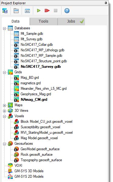

The dialog presents datasets added to your project in a tree-like structure. They are listed in alphanumeric order and grouped by status (see below), then organized by dataset type within each category.
Unsupported formats will either be absent from the list or appear as disabled. Refer to the Application Notes below for more details.
When the dialog is opened from the Project Explorer using the context menu for one or more selected datasets, those datasets will be automatically checked in the list.

Monitoring Progress in Project Explorer:
  • You can track publishing progress while working on other tasks. The status of each job (e.g., processing, completed, failed, cancelled) and the number of jobs being processed are visually indicated in the Jobs tab.
  • New entries for translated and published objects appear in the Jobs tab, under a new node in the tree, marked with the Seequent Evo icon.
  • Failures or warnings are signaled with a notification icon on the job's node. Click the icon to view the captured error or warning. For specific entries/tasks, additional details may be available, marked by either an exclamation icon or a cross mark , providing further insight into the captured error. Click these icons to view more information.
  • Refer to the Jobs section in this topic for more details on monitoring progress and reporting results.
  • In the Data tab: The published dataset's icon will display a modified version featuring the Seequent Evo symbol, indicating that it has been successfully published to Seequent Evo:
The icons of published datasets, displaying the Evo symbol, will be visible in window headers when the datasets are opened in the current project. However, they will not appear in the Map Manager and 3D Manager panes.
