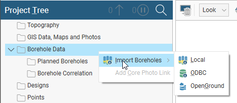

Drilling data forms the basis for creating models in Leapfrog Works. Import drilling data by right-clicking on the Borehole Data folder and selecting one of the import options:
Each of these options is discussed in the Importing Drilling Data topic.

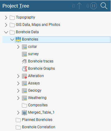

Here, a single drilling dataset made up of a number of tables has been added to the project, stored in the Borehole Data folder:
Here there are three drilling datasets, M Campaign, MAC Campaign and MV Campaign:
You can open each table (
) in a drilling dataset by double-clicking on it. The table will be displayed and you can make changes in it, as described in the Working with Data Tables topic. When there are errors in the data, the relevant table will be marked with a red exclamation mark (
). See Correcting Data Errors in Leapfrog Works for more information on fixing drilling data errors.

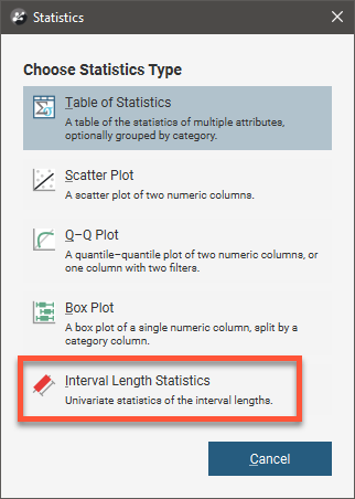

To view statistics on an interval table, right-click on the table in the project tree and select Statistics. The following options are available:
Right-click on a numeric column and select Statistics to open a univariate graph for that column.

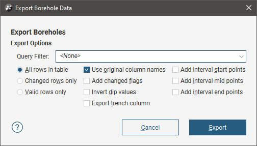

To export all drilling data in a drilling dataset, right-click on the dataset and select Export. The Export Borehole Data window will appear:
You can select whether the exported files includes all rows, only changed rows or only valid rows. You can also apply a query filter, if any have been defined for the drilling dataset.

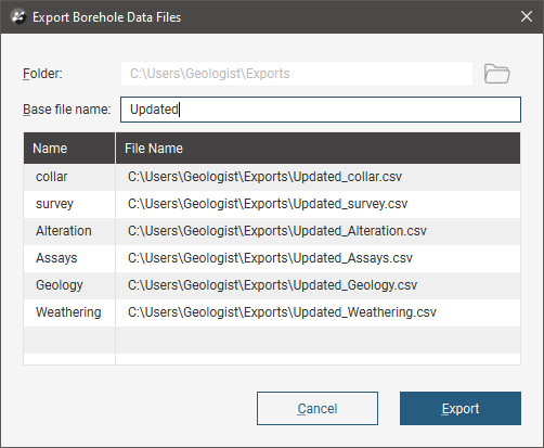

Once you have selected how you wish to export the data, click OK. The Export Borehole Data Files window will appear:
The list shows the files that will be created, one for each data table. Choose the Folder where the files will be saved, then enter a Base file name, which will be added to the front of each file name. However, a Base file name is not required.
Click Export to save the files.

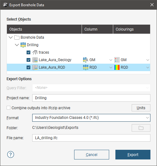

To export a drilling dataset in one of the IFC formats, right-click on the dataset and select Export > Export to IFC. In the window that appears, select the objects you wish to include, then enter a filename.
When an object has more than one colouring option available, you must choose which one you wish to use. If there is more than one colouring option, the other options will be exported as attributes. In this example, different columns are selected when drilling data is exported and the IFC structure is shown in BIMvision. Note that the selected column is exported as a SolidStratum type (in IFC 4X3 RC4) and both columns are included as attributes:
You can also:
- Combine outputs into an archive, in ifczip format
- Change the units used to export the data:
- Length can be in metres or feet
- Plane angle can be in radians or decimal degrees

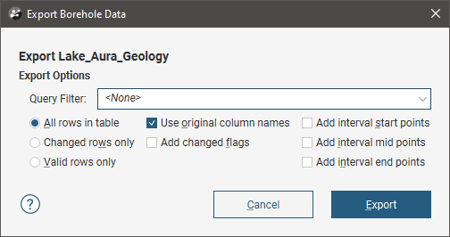

To export a single drilling data table from a drilling dataset, right-click on that table and select Export. The Export Borehole Data window will appear:
You can select whether the exported file includes all rows, only changed rows or only valid rows. You can also apply a query filter, if any have been defined for the drilling dataset.
Once you have selected how you wish to export the data, click OK. You will be prompted for a filename and location.
