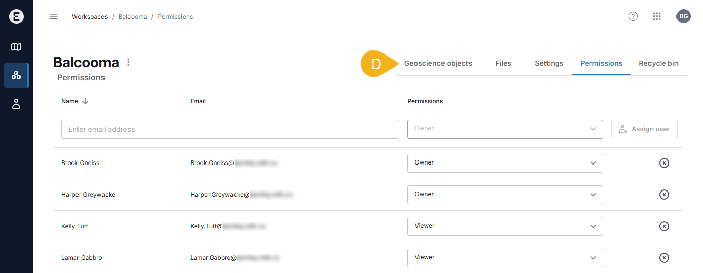

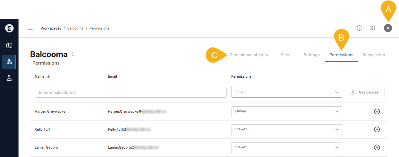

For example, here an admin, Harper Greywacke, is signed in (A) and viewing the Balcooma workspace. Because they are not a member of that workspace, the only option available to them is Manage users (B); the other tabs are greyed out:
They can give themselves permissions for the workspace, and once they do, the other workspace options will become accessible.
