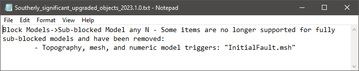

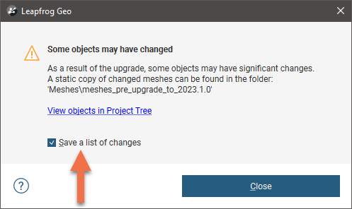

Fully sub-blocked models do not support using open meshes as triggers. For this reason, when a sub-blocked model is upgraded to a fully sub-blocked model, any open mesh used as a trigger will be removed from the block model and Leapfrog Geo will display a message after the upgrade. Click on the View objects in Project Tree link to highlight objects that may have changed, and enable the option for saving a list of changes:
You will then be prompted to save a text file on your local hard drive. Open this file to see identify any meshes that have been removed from the block model:
Grouped meshes can be used as triggers and if you want to use an open mesh as a trigger, first add it to a grouped mesh.

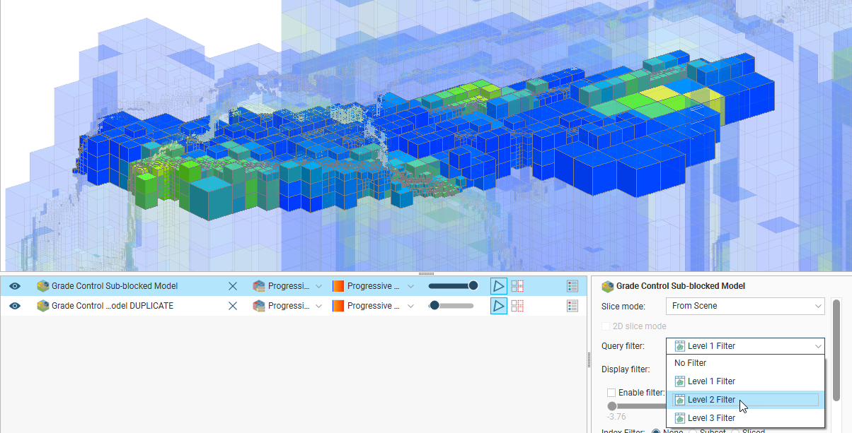

Mesh volumes can be assigned to block models as volume filters. Right-click on a block model in the project tree and select New Volume Filter. Select the volume from the list of available objects.
Volume filters will appear as selectable options in the shape list properties panel’s Query filter, where the volume filter can be selected to show only the parts of the block model within the selected volume.

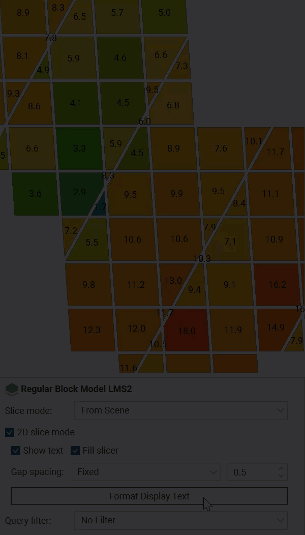

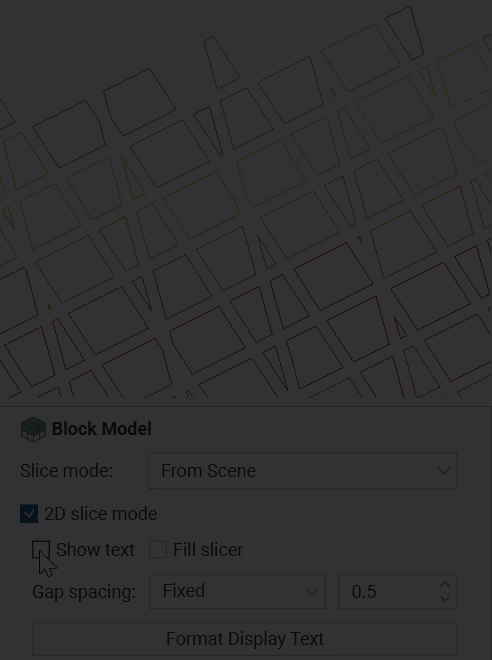

Displaying a Block Model

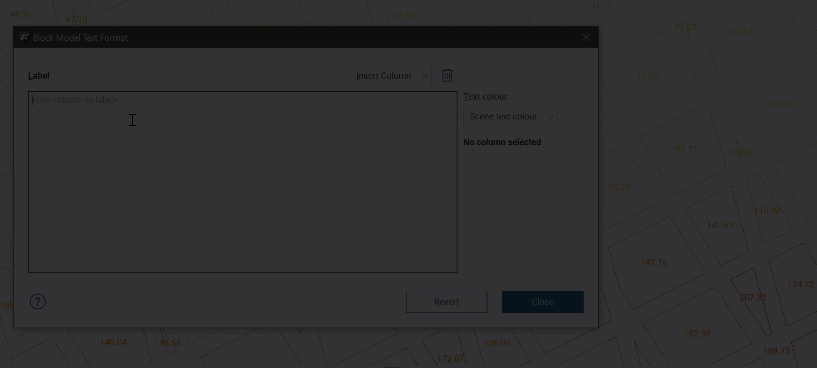

See Formatting Text Displayed in the 3D Scene for more information on how to use the text formatting dialog.

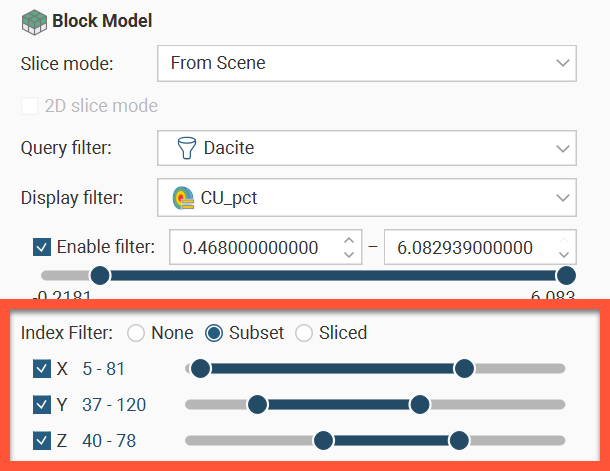

  • Subset shows the union of the selected X, Y and Z ranges.
  • Sliced shows the intersection of the selected X, Y and Z ranges.

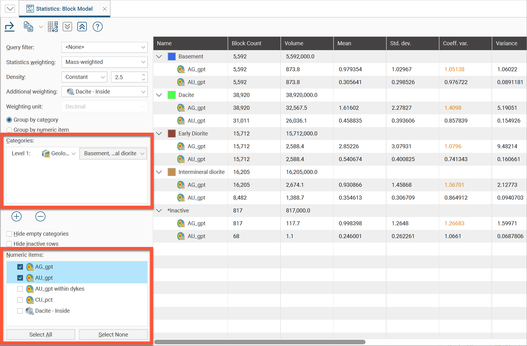

Table of Statistics
The Query filter option uses a related filter to constrain the dataset to a selected subset.

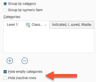

Group by category and Group by numeric column provide options for the table organisation. You can also change what columns are displayed in the table by clicking the Edit columns button (). This opens a window in which you can select the columns that are displayed in the table:
Click rows to select them, and select multiple rows by holding down the Shift or Ctrl key while clicking rows. You can then copy rows by clicking the Copy button (), which allows you to copy the selected row(s) or all rows in the table.
The arrow buttons quickly expand () or collapse () rows.
