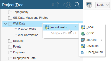

Drilling data forms the basis for creating models in Leapfrog Energy. Import drilling data by right-clicking on the Well Data folder and selecting one of the import options:
Each of these options is discussed in the Importing Drilling Data topic.

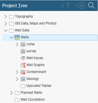

Here, a single drilling dataset made up of a number of tables has been added to the project, stored in the Well Data folder:
Here there are three drilling datasets, M Campaign, MAC Campaign and MV Campaign:
You can open each table (
) in a drilling dataset by double-clicking on it. The table will be displayed and you can make changes in it, as described in the Working with Data Tables topic. When there are errors in the data, the relevant table will be marked with a red exclamation mark (
). See Correcting Data Errors in Leapfrog Energy for more information on fixing drilling data errors.

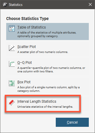

To view statistics on an interval table, right-click on the table in the project tree and select Statistics. The following options are available:
Right-click on a numeric column and select Statistics to open a univariate graph for that column.

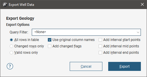

To export all drilling data in a drilling dataset, right-click on the dataset and select Export. The Export Well Data window will appear:
You can select whether the exported files includes all rows, only changed rows or only valid rows. You can also apply a query filter, if any have been defined for the drilling dataset.

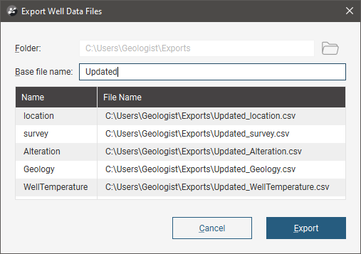

Once you have selected how you wish to export the data, click OK. The Export Well Data Files window will appear:
The list shows the files that will be created, one for each data table. Choose the Folder where the files will be saved, then enter a Base file name, which will be added to the front of each file name. However, a Base file name is not required.
Click Export to save the files.

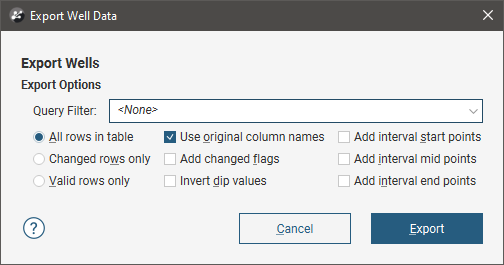

To export a single drilling data table from a drilling dataset, right-click on that table and select Export. The Export Well Data window will appear:
You can select whether the exported file includes all rows, only changed rows or only valid rows. You can also apply a query filter, if any have been defined for the drilling dataset.
