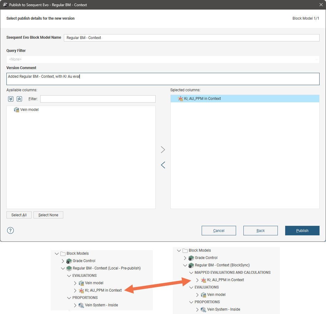

A local block model has data columns in the Evaluations list in the project tree. When that block model is published to Seequent Evo, some or all of these evaluations can be published along with the model definition. The published evaluations will be moved into the Mapped Evaluations and Calculations list. This lists the data columns that are now stored in Seequent Evo. For example, here the block model was published with a single evaluated column:
In the local block model, before upload, that evaluation appeared in the model’s Evaluations list, shown on the left. In the published block model, shown on the right, the published evaluation has been moved to the Mapped Evaluations and Calculations list and no longer appears in the Evaluations list. Unpublished evaluations remain in the Evaluations list.
Unpublished evaluations in the Evaluations list remain local and will not be modified when Reload from Seequent Evo is selected to update the block model. Evaluations that are listed in the Mapped Evaluations and Calculations list will be overwritten when Reload from Seequent Evo is selected to update the block model, because those data columns have been selected to link to the BlockSync block model.
Publishing the model again, this time including the other evaluations, will result in those columns being moved into the Mapped Evaluations and Calculations list:

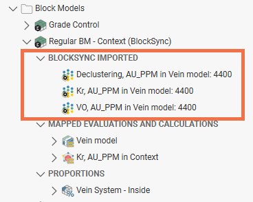

Columns published to the BlockSync model by another Leapfrog Geo user will appear in the BlockSync Imported list in the project tree when the block model is reloaded from Seequent Evo:
These imported block model columns have no local columns mapped. These data columns in the BlockSync Imported list indicate that the remote BlockSync data is being referenced and used in the model.
It is possible to create a corresponding local evaluation in the block model, which will appear in the Evaluations list. However these two columns will be independent, and changes made to the local evaluation will not update the BlockSync block model. To link these so local changes can be updated to a shared block model, use Column Mapping, which is described below.

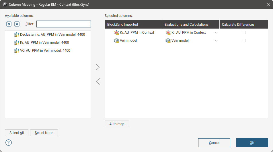

You cannot directly make changes to BlockSync imported columns in a BlockSync model. In order to update these imported columns, you need to map a local column to the imported column; the local column then has priority over the BlockSync column, and when the model is next published, that data in the column overwrites that in the BlockSync model, which results in a new version of the block model being added to BlockSync.

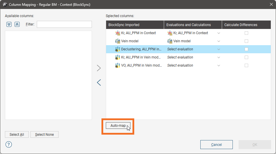

To map imported BlockSync columns to local columns, add a local evaluation to a BlockSync-linked block model. Next, right-click on the block model in the project tree and select Column Mapping. In the window that appears, select from the Available columns in the BlockSync model columns that you wish to map locally.

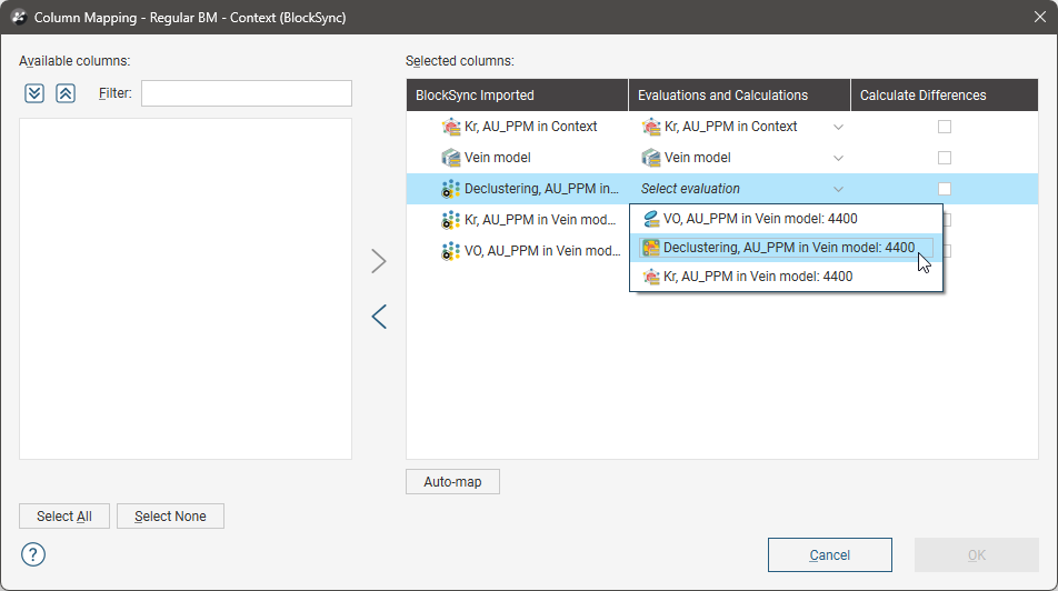

Next, in the Evaluations and Calculations column, select the local evaluation that you want to link to the BlockSync model’s evaluation. Here, for example, a locally updated declustering evaluation is mapped onto the declustering data column imported from BlockSync:
When using matching column names, click the Auto-map button to automatically pair up matching imported columns with local evaluations and calculations. The name match is case-insensitive.
Click OK to map the imported columns to the selected evaluations.

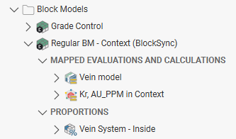

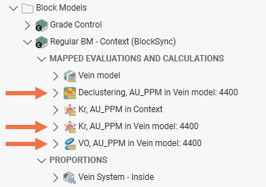

Once the columns are mapped, the BlockSync column evaluations will no longer appear under a BlockSync Imported list in the project tree, but will instead appear in the Mapped Evaluations and Calculations list.

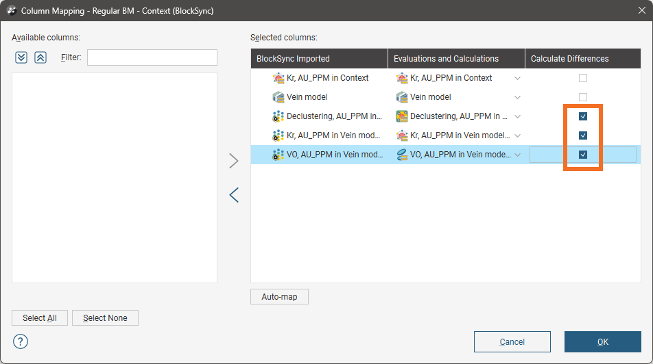

The Calculate Differences option in the column mapping window provides a way to easily visualise the differences between the local evaluation and the remote BlockSync imported column:

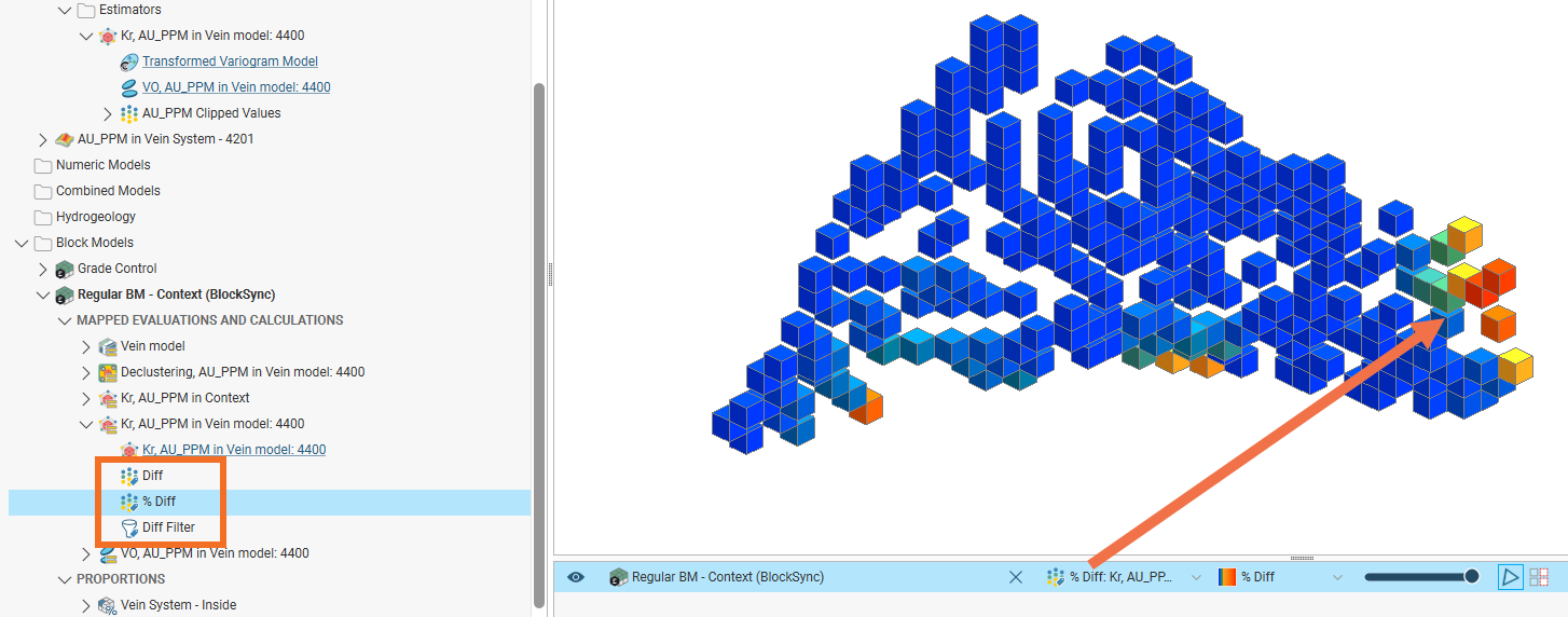

When Calculate Differences is enabled, two difference values and a difference filter are added to each of the mapped evaluations. These can be used to display the block model in the scene and visualise the differences between the imported values and the locally mapped values:
