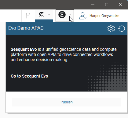

Once you are signed in to Evo, a button will appear in the upper righthand corner of the main window, next to the user ID menu. Click the button to open the Evo menu:
From the Evo menu, you can:
  • Open the Evo settings window to view the workspaces available and, if you have access to more than one Evo instance, switch between instances. Click the Settings button (). The workspaces displayed in this window are those you have permissions for in the selected instance.
  • Refresh Evo information, such as the instances and workspaces you have access to. If you have recently been added to an instance or a workspace and cannot see the instance/workspace in Leapfrog Geo, click the Refresh button ().
  • Publish some or all of the current project’s data to an Evo workspace. To do this, click the Publish button. See Publishing Data to Seequent Evo for more information.
There is also a link to Seequent Evo that opens evo.seequent.com in a browser window.
