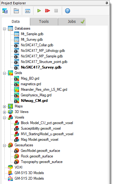

Imported Data
Successfully imported datasets are stored in the current project folder and automatically added to the Data tab in the Project Explorer. Their icons will display a modified version, featuring the Seequent Evo symbol, indicating successful import from Seequent Evo.
Opening Imported Datasets
If the Download and open option is enabled in the import dialog, datasets will open automatically in the current project workspace. Their icons, displaying the Evo symbol, will be visible in window headers when the imported datasets are opened in the current project. However, they will not appear in the Map Manager and 3D Manager panes.

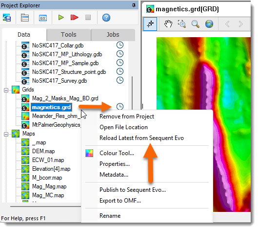

Reload from Seequent Evo
When a new version of an imported object is released in Seequent Evo, its counterpart in the Project Explorer is marked as out-of-date with a blue status indicator next to it. Additionally, the context menu for the affected dataset will include a new option: Reload Latest from Seequent Evo.
If the dataset is deleted or moved from the project folder, it will appear greyed out and flagged with a warning icon. Use the Find option in the context menu to locate the missing file via the browse dialog. (See Missing Data Files for more details.) Once a missing dataset is manually located, the blue "reload" status indicator will reappear.
To update the dataset, select it and right-click on the new option. An update confirmation prompt, Import Geoscience Objects, will appear:
  • Selecting Cancel retains the existing dataset, keeping the status indicator visible.
  • Selecting OK imports the latest from Seequent Evo, including the most current colourmap version for grid and voxel types, and updates the dataset. Once the update is complete, the status indicator and the new context menu option will no longer be available.

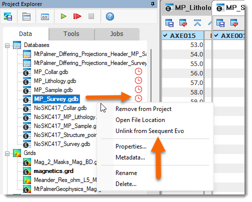

Unlink from Seequent Evo
If a dataset's counterpart in Seequent Evo is no longer available—for example, if the geoscience object has been recycled, the workspace has been deleted, access has been revoked, or there are network or Evo service issues— a red status indicator will appear next to the dataset in the Data tab, and a new context menu option, Unlink from Seequent Evo, will become available.
Select this option to remove the Evo reference from the flagged dataset. Once unlinked:
  • The dataset will no longer display the Seequent Evo icon.
  • The red status indicator and context menu option will be removed.

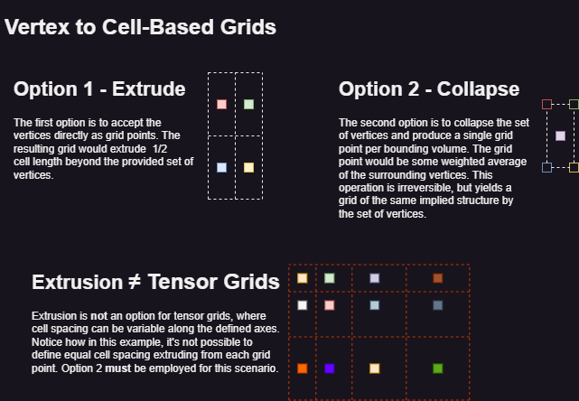

Grids can be defined by cells or vertices. When importing vertex-based 2D/3D regular grids, a conversion to cell-based regular grids will take place. The grid size is extended by one along each axis, and the vertex data is imported as grid points. The resulting grid/voxel will extrude 1/2 cell length along each axis (see "Option 1" in the attached illustration below).
A geoscience object may contain multiple cell or vertex attributes. Importing a multi-attribute 2D grid or 3D grid generates multiple grids/voxels—one for each valid cell/vertex attribute encountered in the object. All generated grids/voxels share the same coordinate system (CS) and CS units when sourced from a single file.

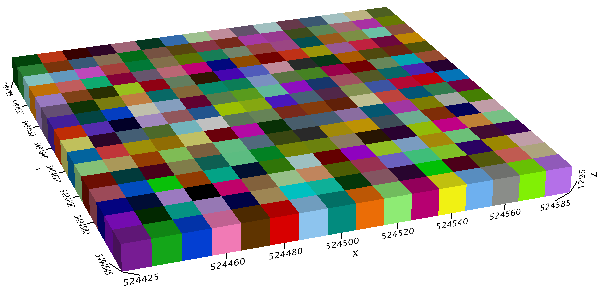

Tensor 3D Grids
Tensor 3D Grids: These types are imported into Oasis montaj as Geosoft numeric voxels with varying cell sizes. Cell-based tensor 3D grids can also be imported into Oasis montaj as thematic (category) voxels.
When importing a vertex-based tensor 3D grid, an average of the cell vertices is calculated to generate a center-cell grid point (see "Option 2" in the attached illustration below).
Conversion Between Vertex-Based and Cell-Based Regular Grids
Certain object types are not supported in Oasis montaj—including 1D geophysical models and point datasets—and will not appear in the Import from Seequent Evo dialog.

Thematic (Lithology) Voxels:
  • If no colourmaps are available for an imported thematic voxel, a default category colour palette is applied.
  • The image below illustrates sequential categories in each voxel cell (starting from the lower-left corner) to demonstrate the palette used for thematic voxels.
