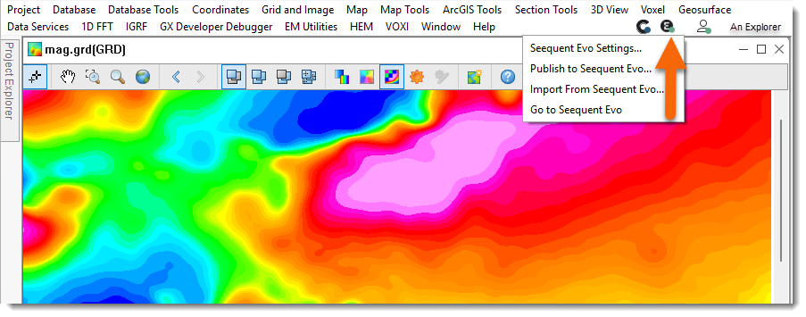

Seequent Evo Menu Options
Click the Evo icon to expand its menu options:
  • Seequent Evo Settings: Use this option to connect to a Seequent Evo instance. Once connected successfully, the Evo icon will update to (or remain unchanged) to reflect the connection status. Hovering over the icon will display the name and hub of the connected instance.
    If the icon changes to and displays "Connection to Seequent Evo service unavailable" on hover:
    • Check your internet connection—it may be disrupted.
    • Reconnect to your Seequent Evo instance by opening the Seequent Evo Settings dialog and selecting your instance from the list.
  • Publish to Seequent Evo: Open the Publish to Seequent Evo dialog by selecting this option. You can also access it from the Project Explorer's Data tab via the context menu for applicable datasets. The option is disabled if no instance is selected.
  • Import from Seequent Evo: Open the Import from Seequent Evo dialog with this option. It is also accessible via the context menu in applicable nodes within the Project Explorer's Data tab.The option is disabled if no instance is selected.
  • Go to Seequent Evo: Click this option to open the Seequent Evo portal in your web browser. The option is disabled if no instance is selected.
