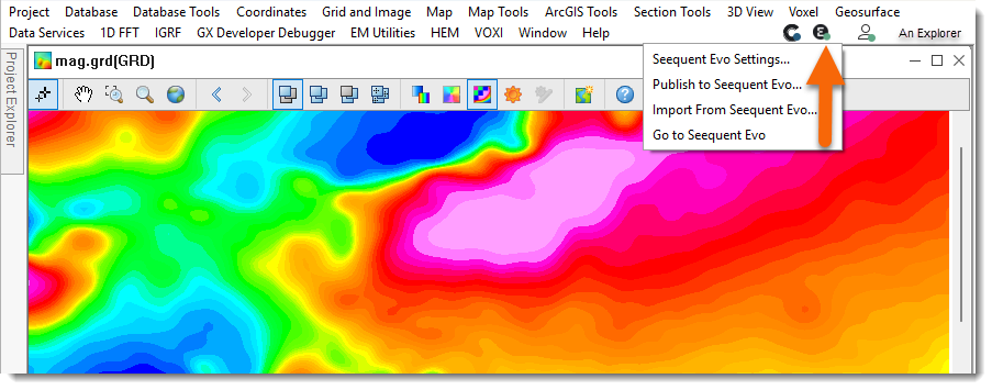

Seequent Evo Menu Options
Click the Evo icon to expand its menu options:
  • Seequent Evo Settings: Select this option to connect to a Seequent Evo instance. Upon successful connection, the Evo icon updates to (or remains the same), indicating the connection status. Hovering over the icon displays the name of the connected instance.
    If at any point the icon changes to and hovering over it displays "Connection to Seequent Evo service unavailable", follow these steps:
    • Check your internet connection, as it may be disrupted.
    • Reconnect to the Seequent Evo instance by opening the Seequent Evo Settings dialog and selecting your instance from the list.
  • Publish to Seequent Evo: Open the Publish to Seequent Evo dialog by selecting this option. You can also access it from the Project Explorer's Data tab via the context menu for applicable datasets.
  • Import from Seequent Evo: Open the Import from Seequent Evo dialog with this option. It is also accessible via the context menu in applicable nodes within the Project Explorer's Data tab.
  • Go to Seequent Evo: Open the Seequent Evo portal in a web browser. If you are not signed in, the evo.seequent.com/login page will appear. Click the LOGIN button in the top-right corner to sign in with your Bentley account.
